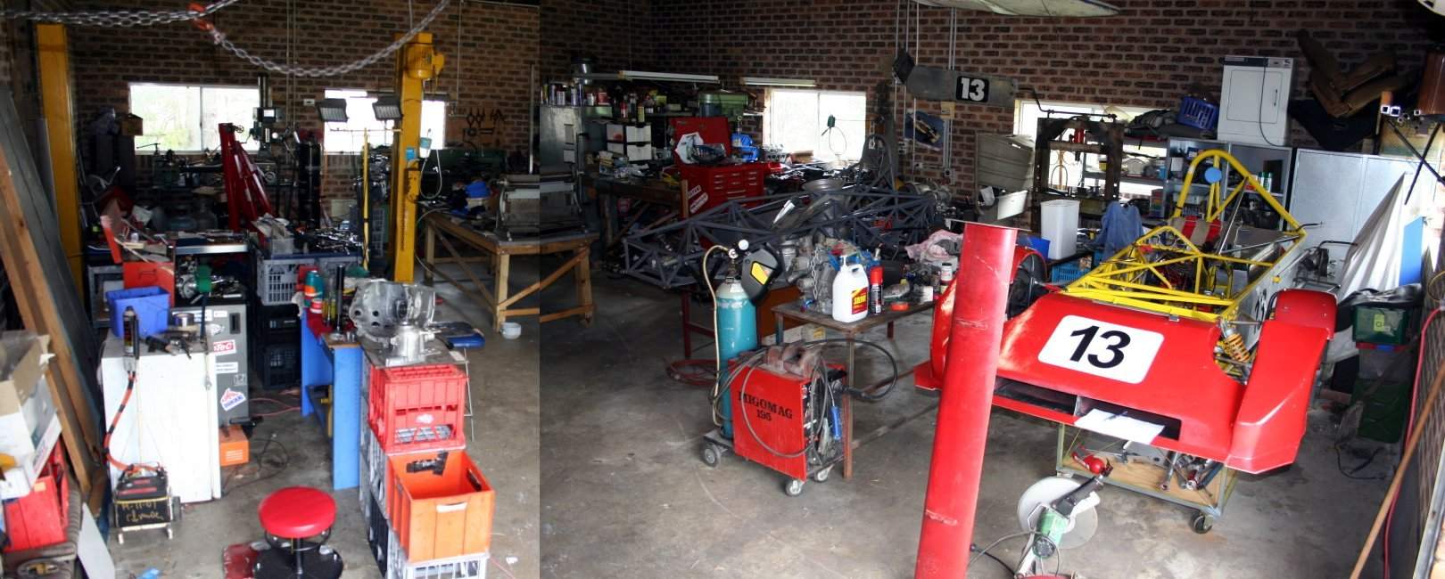

    Cracked the shits finally and started the big clean-up in the garage. I did a bit a few days ago, and a lot more this morning.
    I shifted a lot of the gear around so there's effectively more space and the car bays are much better organised.
    Still a huge amount of cleaning up to do, after many years of neglect, and I have to make plenty of shelves on the walls to put various crap.
    But it's a start at least.
