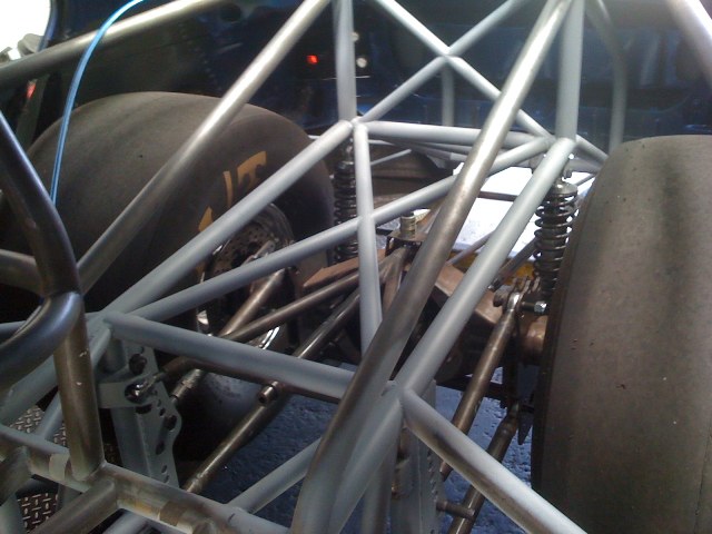

    it was the only way to get the diff back to where we needed it..
    shifter mounted today.. switch panel will be done tomorrow, throttle pedel done and just needs to be mounted..

    tube widths need a little adjusting on the diff. fitting floaters was the easiest way of doing this

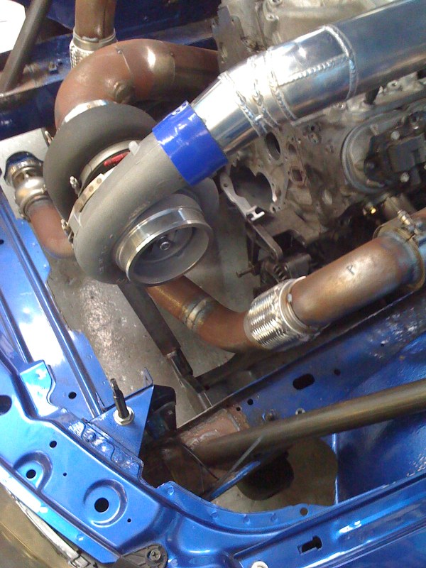

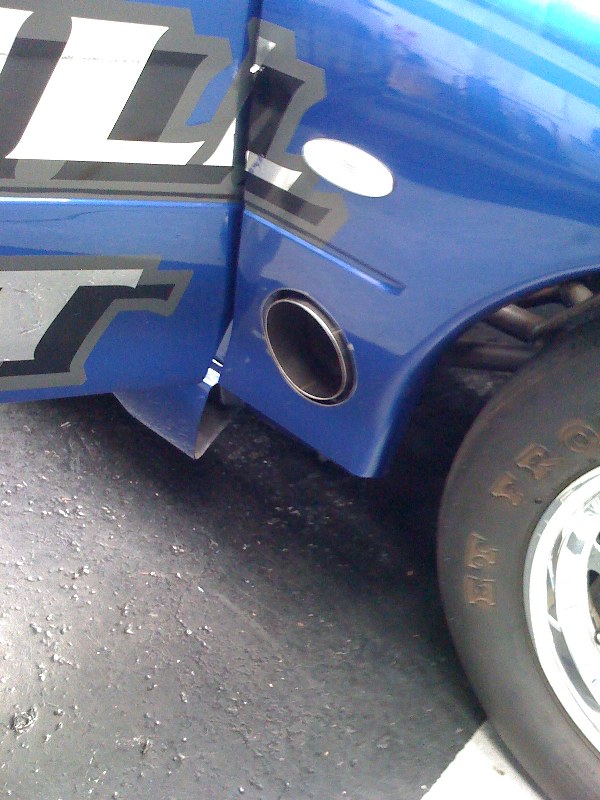

    Awsome work, love the exhaust outlet.
    So is there going to be an ice cooler in the cabin?

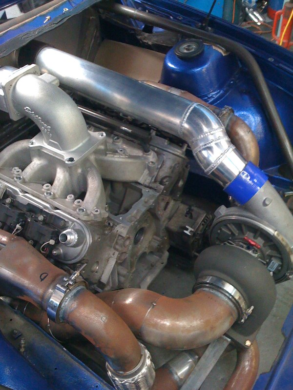

    had a look today, the turbo is even bigger in real life!

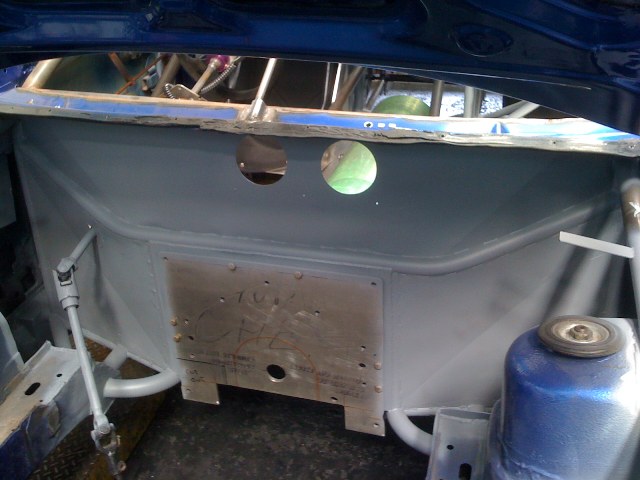

    ok some progress
    firewall all finished, cage getting painted next week then car off to panel shop next week

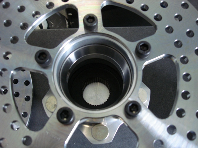

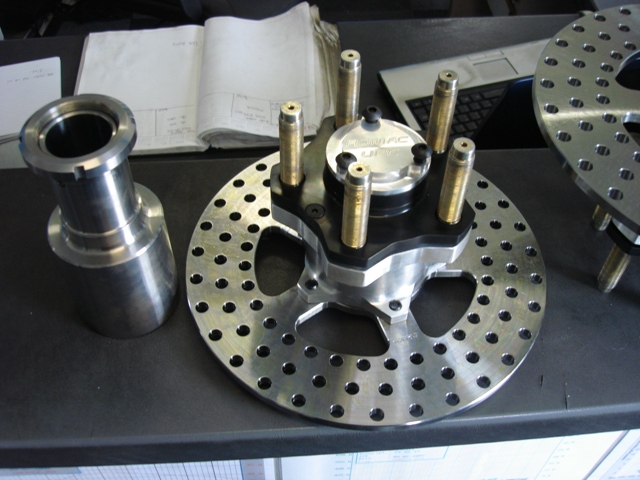

    Having never had any experience with a proper drag car, can u explain how the floating axles work? From what i know, you use floaters so that if you snap an axle there's no chance the wheel will sieze and as such you won't spear into the wall?
    I assume that (from the pictures) the axles are splined both ends?

    if u snap an axle, even with a floater u will spear the wall, but with the floater set up the axle is only in torsion, there is no bending moment on it. On a standard axle the axle that is in the diff is also holding the wheel, all the work is not being done by the wheel bearing, where it is in a floater setup.

    its more if you snap a axle the wheel wont fall off... you can still control a car on 4 wheels, when it is on 3 you cant steer
    and you need them for sub 7.50's...

    Hey whats going on with the front chasis rail on the drivers side, looks like its floating in air while the rhs one looks connected to the fire wall.
    Quote Originally Posted by Einstein
    The definition of insanity is repeating the same action and expecting a different result
  28. #58
    sack riding 10sec rx7's Avatar
    Join Date
    Nov 2001
    Location
    Sydney
    Posts
    13,670
    they are both connected to the firewall
