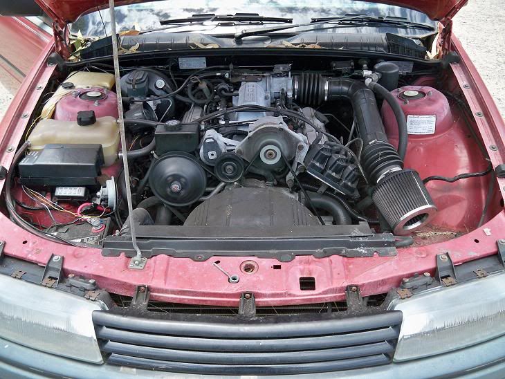

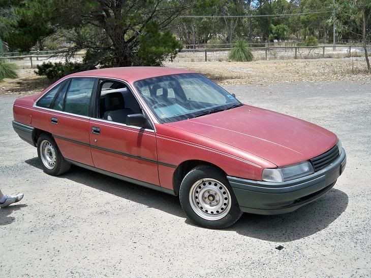

    So we went out and bought this.
    Full running and driving VN series 1 with ice cold air con.

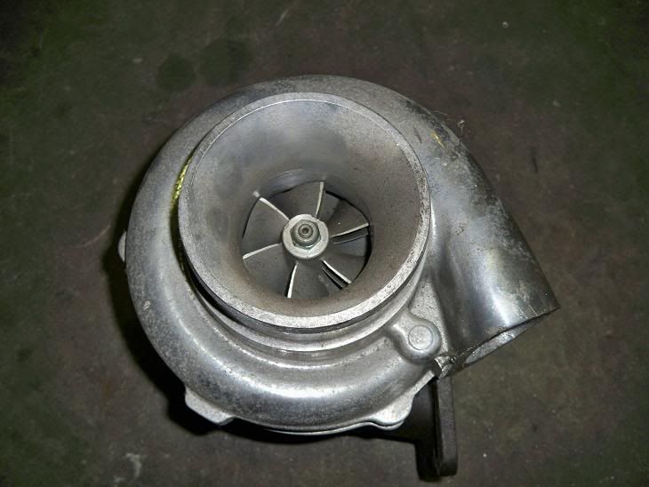

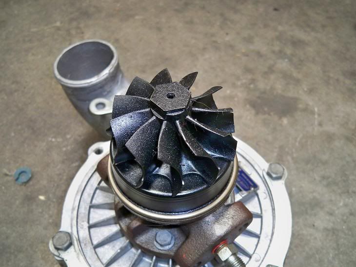

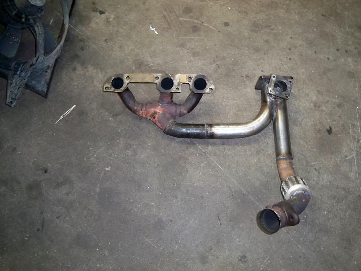

    Our first idea (and only real option) was to turbo it so we bought this turbo with munted front cover and leaky oil seal.

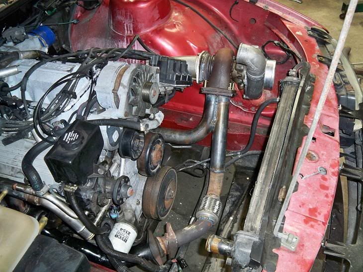

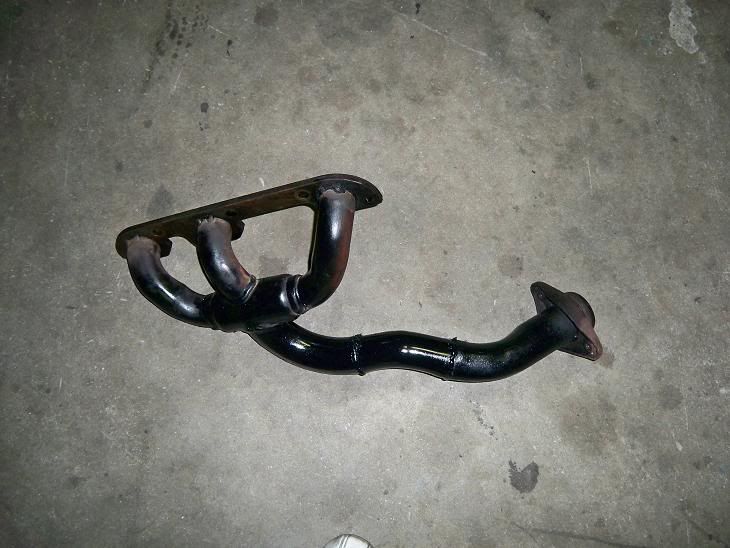

    So this weekend just past we thought that we shoudl get some shit done so we modded the standard manifold using sections of the stock exhaust to make these.

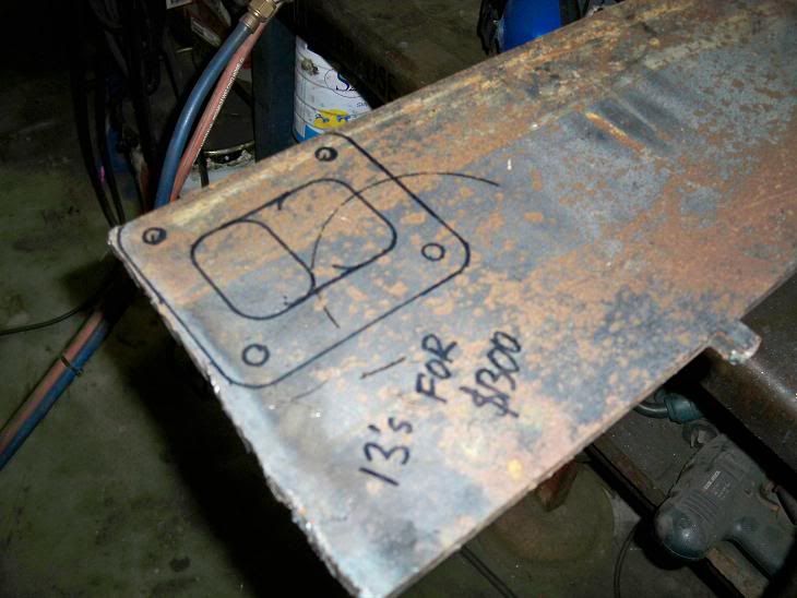

    And used some scrap 10mm plate for a T4 flange
    So after all our work so far this is how it looks.

    VN : $250

    T4 flange made from scrap : $10

                ECU? Why did you add a flex joint?
                  I would guess and say the flex joint was already attached to the recycled pipework
                              He has allocated 30 bucks to it . . .
