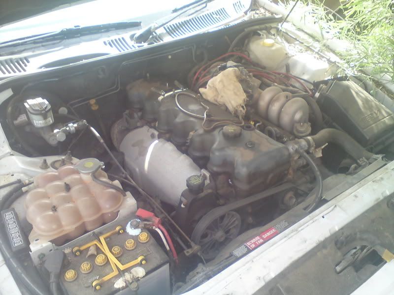

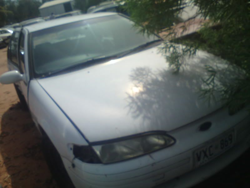

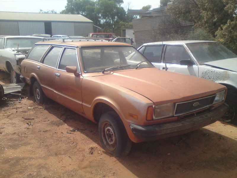

    Ok, my entry is a TE Cortina wagon. Picked this thing up for $150 with no gearbox and a cooked 2L. And the other half is a EF futura that some guy parallel parked in a tree that I picked up for $350.
    I'll get it into the shed and start taking more photo's as soon as I get my 4x4 out (ie- lunch time)
    Anyway here's pics!

        Good score. Expect a tad over 100rwkw. While I'm not 100 sure, you might be able to get a corty xflow sump onto that block, or at the very least trim the EF sump above the pan rail and cut and shut them together (tack to an old block while welding). Oil pick up from a corty crossflow also needed.

          sump and pickup will fit, just have to relocate the dipstick for the oil.
            major mods required to sump need both cortina and ef sumps you need EF pan rail and cortina bowl and then a few hours blending them together
            need to recess the firewall slightly and fab custom engine mounts
            if its a 4 banger you'll need to un stitch the gearbox crossmember mounts off the floor and move them, radiator support panel needs to be modified to take a 6 cyl radiator
