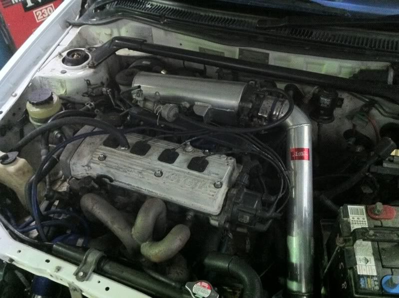

    picked up the new project car about a month back....an old friends neglected AUDM Starlet EP91, that has been converted to 4EFTE power. Had suspencted Blown...in teh process of fixing it

    Huge intercooler means rough fitment of front bar....and yeah...bit of white paint to camouflage the intercooler pipe haha

    Dodgy fitting for the injector harness, which need cleaning up..
    TD04!
    This is the culprit for the rough idling...That hole under "5E" should be lined up with little indent on the head. Its at least 4 teeth out!
    Hopefully get this all cleaned up and presentable...make it look stock

                    The 5e timing mark is not the one you want to use, you need to use the 4e one..
