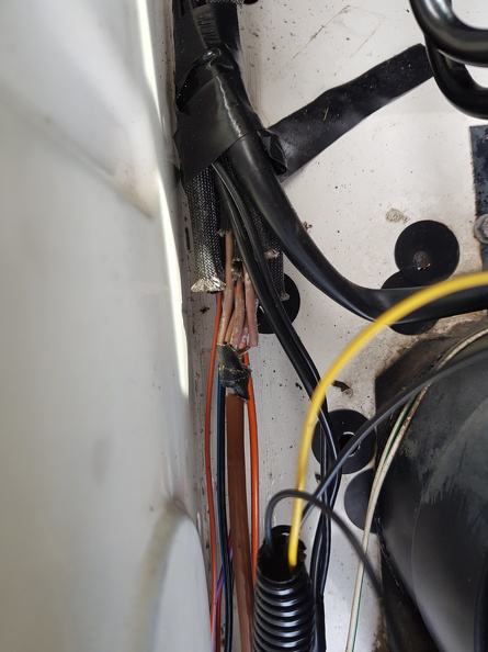

    Living up to stereotype of potentially catching fire, surely this isnt standard?
    Goes here
    While on topic of wiring, this is a stereo "install"
    Yes. Thats an inline fuse holder taped to the loom and a random join in power wire thats uninsulated
    Cunts shouldnt touch cars if they dont know what they are doing. Its not hard to fix but fuck...
