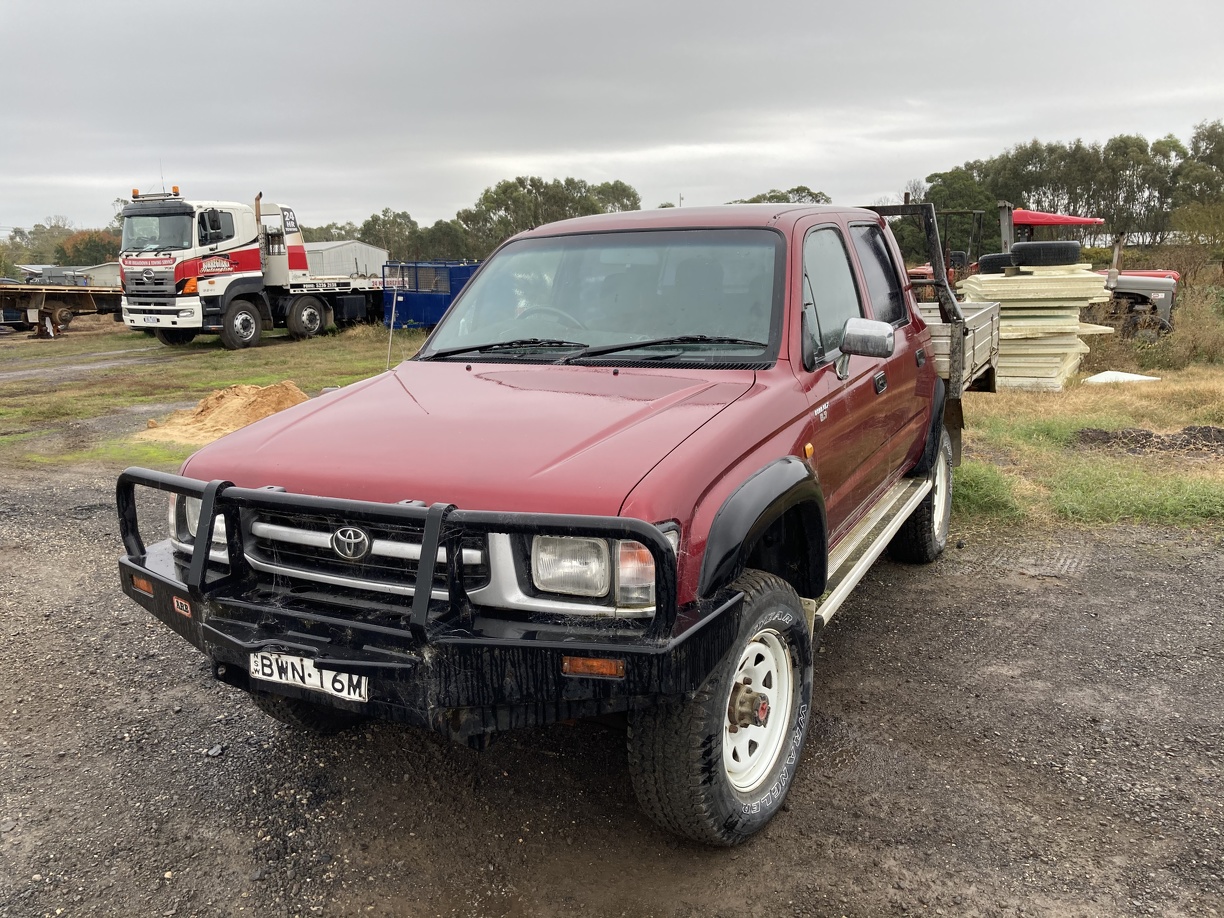

    Body is reasonable, with a few little dents and ripples. No major rust, and has an ARB front bar:

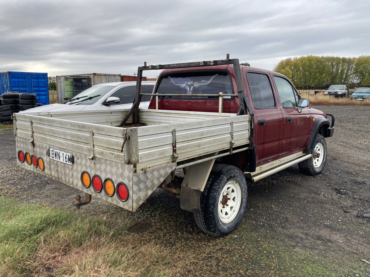

    Has a tray with absolutely hideous lights:
    A little bit mullet like. Sensible at the front, bogan at the back. According to old mate he bought it while on holidays in Deniliquin, so those lights and the RM Williams stickers probably fits in fine.

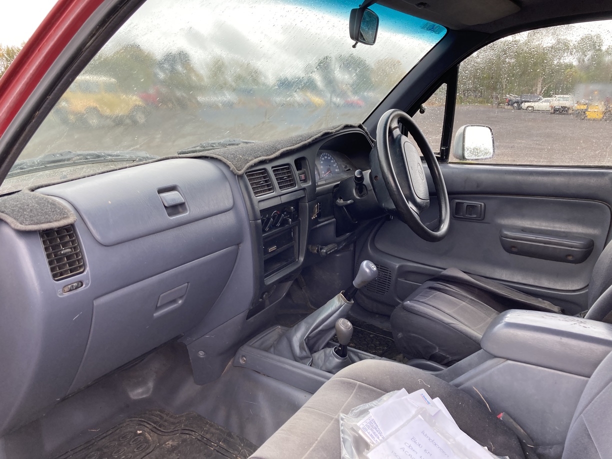

    Interior is reasonable, a far cry from most of the tradie utes which have smashed glove boxes and upper boxes:
    Seats are a bit how are you doing, but Ill put Subaru ones in like I did on the old Hilux.

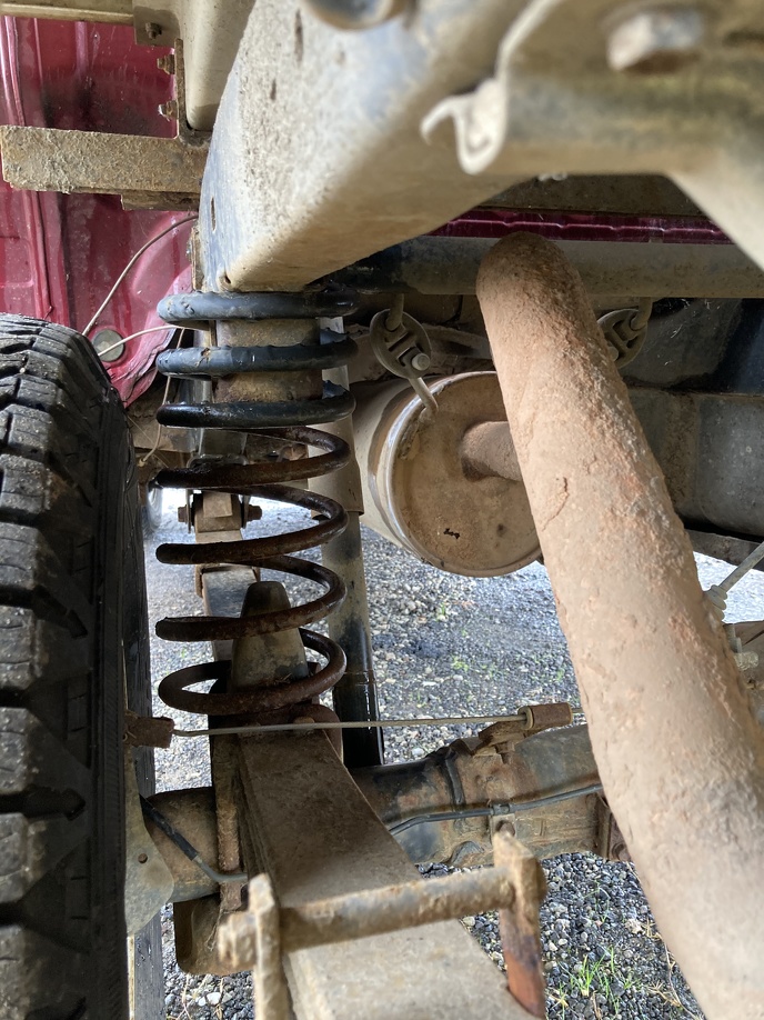

    Rear suspension has some interesting mods too. I reckon the suspension was sagging a bit too much for someones liking and they have shoved secondary coil springs in for assist:
    Its currently bucketing down here so I havent been able to look at it much since it got dropped off by the towie, but im sure there are things which will need to be done. Considering putting a full suspension kit through it for a 2" lift, and probably replacing all the idler and pitman arms and bushes in the steering. All of that is cheap enough to do straight up.
