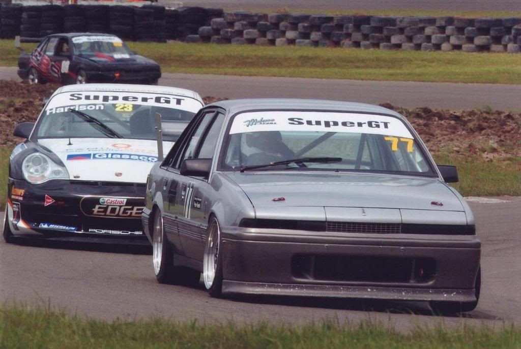

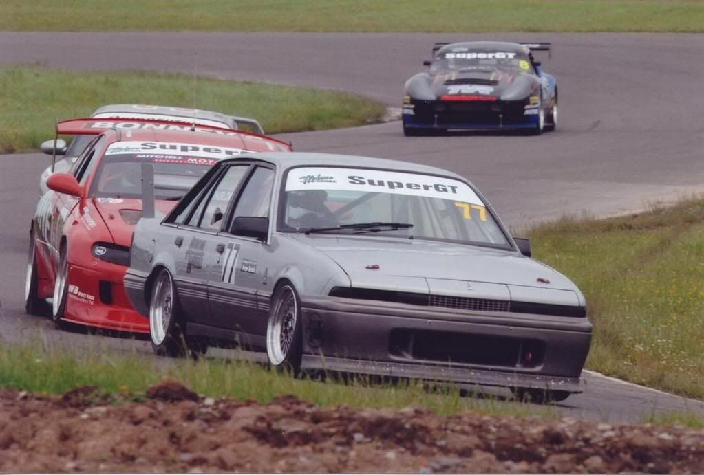

    I have owned the car for 13 years, it was a std calais turbo when I bought it, and I have slowly modded it as funds have allowed. I do all the work on the car myself (with help from my brother).
    Specs are:

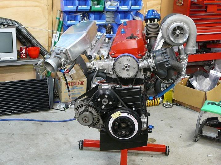

    RB30ET:

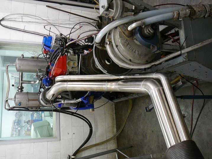

    GT35 (1.06) custom stainless manifold, 45mm progate, 4" main and 2" screamer both exit side of the car, Motec, 750cc, magnafuel reg, motec rail, 044, 2 holley red lift pumps, cam grind, ported head, std headgasket, ferrea, argos, CP's, ARP studs top and bottom, ATI, N1 pumps,
    Made 652hp and 580ftlbs on engine dyno
    Gearbox:
    Um, auto........ (best part of the car - serious!)
    Manual VB, billet servo, kevlar band, race/more clutches, all KEAS parts, thanks Paul for your help and supplying parts
    Diff:
    BW- fully welded housing, shortened 40mm, 9" axles, 3.08 / 3.23, spool
    Brakes:
    Front - alcon 323mm x 32mm race rotors, billet hats and Wilwood billet differential piston SL 4 pots
    Rear - wilwood 310mm x 21mm race rotors, wilwwod hats and Wilwood dynalite 4 pots
    wilwood firewall mount pedalbox, 2 x tilton masters with bias adjuster in dash
    3" ducts
    Suspension:
    Koni DA all round, king race coils, custom bars, turetted rear with true coil overs, rose joints throughout. 17 x 10 arrow wheels (BBS 3.6mm shells) dunlop D11 slicks 265/625/17
    Upgrading a few things at the moment like: intake manifold, camshaft, valvesprings, cooler pipes, bigger cooler, rear wheels, turbo, 2nd 044, Fibreglass bonnet and bootlid, smaller fuel tank etc etc
    season starts again in september, cant wait

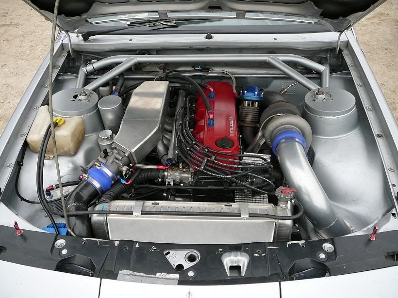

                  fark yeah - is that a "fuel cooler" set-up too?
                  best VL eva x 2
                    pity it is not the best VL in Australia though
                      No such thing on the car
                      Classic Auto Fabrications:
                      https://www.facebook.com/pages/Class...88753937823811
                      http://www.lescollinsracing.com/
                        what is this cooler here? certainly not an oil cooler?!?!
                          power steering cooler?
                            Bingo.
