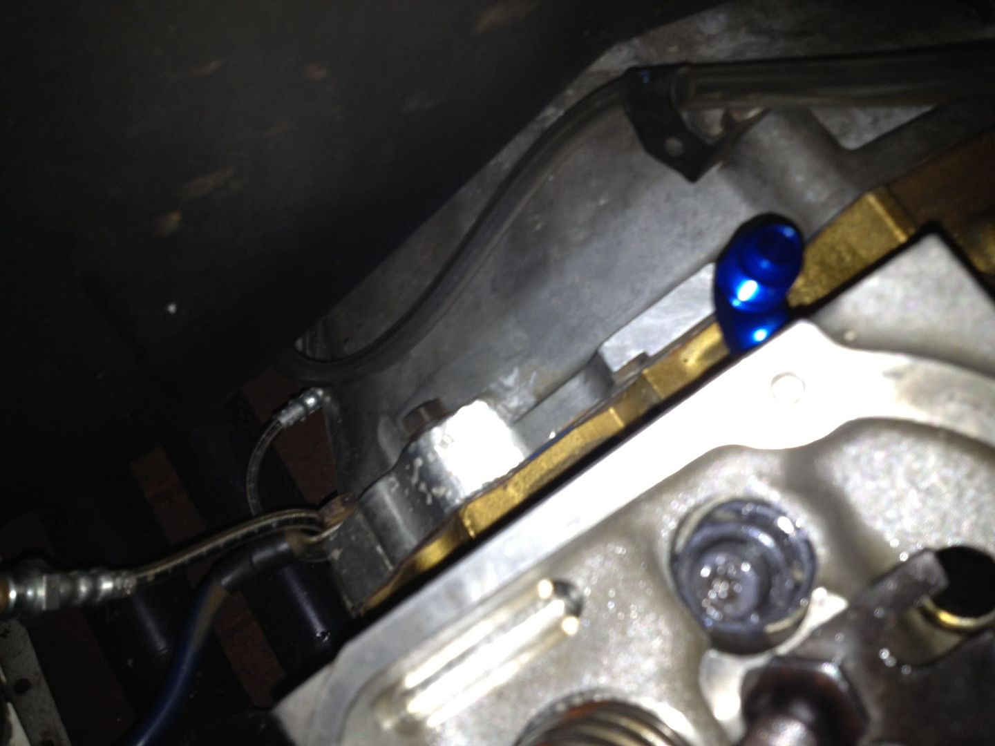

      My cooling system has -4 bleeds at the back of the cylinder heads that bypass the thermostat and merge into the top hose, very stable temps and no boiling at shut off.
          Thanks. Like to see your system?

                      Here is what I did to my cooling system with rear bleeds
                      Originally posted by Fluffy Front Bum View Post
                      Drilled and tapped coolant bleeds into the rear of each head with-6 lines, also put 1/8 bleeders in the front for initial fill.
                      Put heads on with Cometic MLS
                      Made up lines with 100 series Speedflow fistings.
                      Which re enter system at top hose.
                        Just get an 07K in there. The old excuse is no longer valid!
                          Thanks for that FFB. Actually looks not unlike something I've seen elsewhere. I am definitely going to look at doing something like this on the next motor. Perhaps on this motor too.
