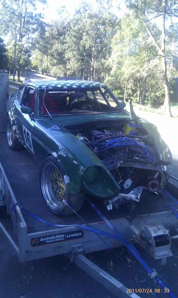

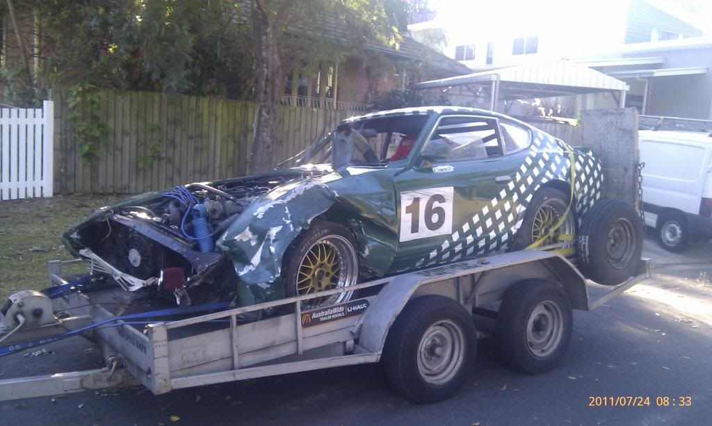

    Back to the 240, this is how it ended up after taking on the fence at Lakeside......
    Basically munted, the left front chassis rail was pushed back about 12 inches and down about 6 inches, the left A pillar was pushed back about 3mm and once opened the left door wasn't going to close ever again. The welds in the firewall and floor in the left footwell were popped and the floor tweaked on both sides and the transmission tunnel. As a car it was never going to run again, a 40 year old shel with that much damage is something I didn't want to drive again.
    After a few weeks to think about options, it was decided to sell off the bits from the car and build something new. As I had always raced dirty Datsuns on the cheap, and S14's were cheap and eligible for Prosports I decided to build one.

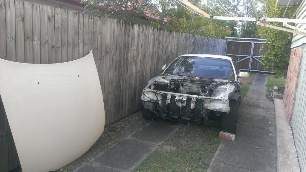

    So in November 2011, this was found on Ebay in Brisbane......
    An absolute bare shell.
    Trawling Ebay saw me pick up various parts for cheap like rear bars, tail and headlights, and brakes, Z32 alloy 4 pot calipers and rotors for the front and R33 GTR twin spots for the rears, a couple of doors and a couple of cheap motors.

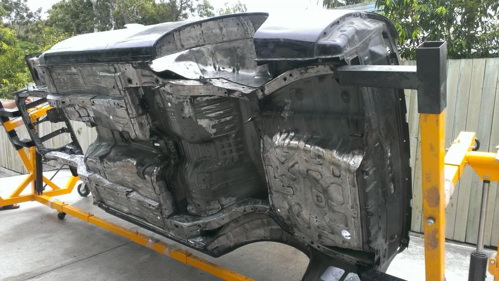

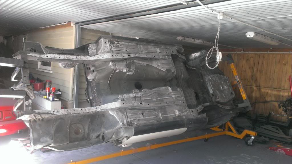

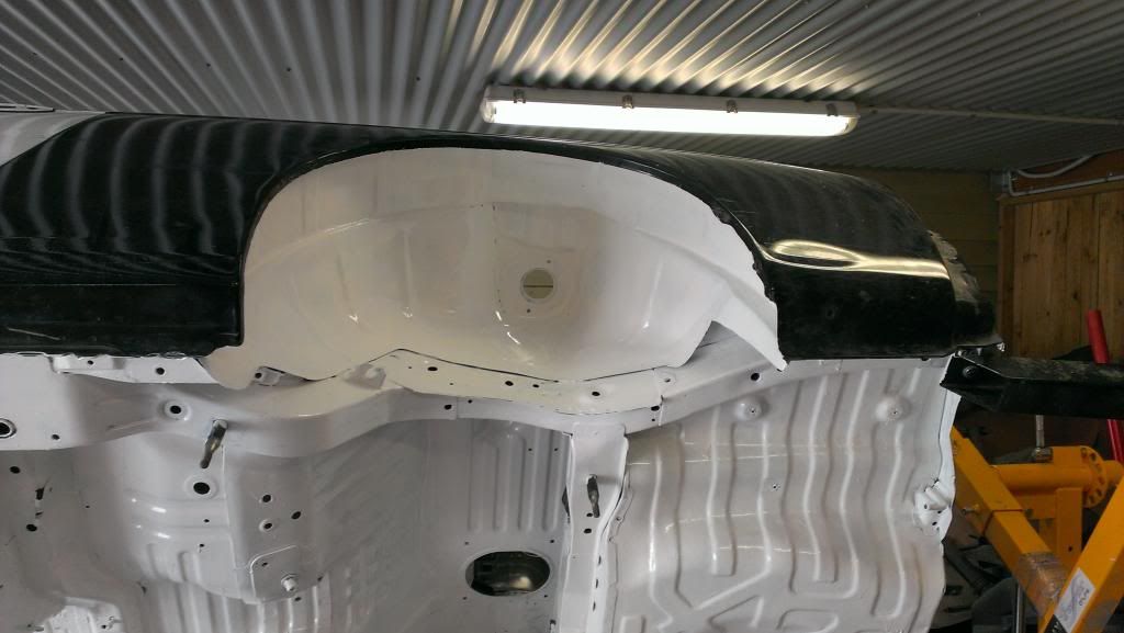

    Next step was to prepare the underside of the car by removing the sound deadener and also tidy up the wheel wells, so a cheap china rotisserie was bought and the car could be spun around.

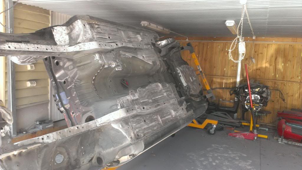

    With help from Muz some KBR was sourced to paint the underside, wheel wells and engine bay. Before that could be done I made myself really popular with the neighbours.....
    After a couple of weekends and a few afternoons/evenings after the work with the grinder and countless paint stripping wheels and coming out of the garage looking like an old school coal miner with the dust we ended up with this....
    Ready for the KBR to be brushed on.
    The car sat on the rotisserie for a few months as the fun tickets had run out, and so was my work contract, but I had squirrelled away some money for the rear cradle and then the scope blew out a touch as things do to end up with:

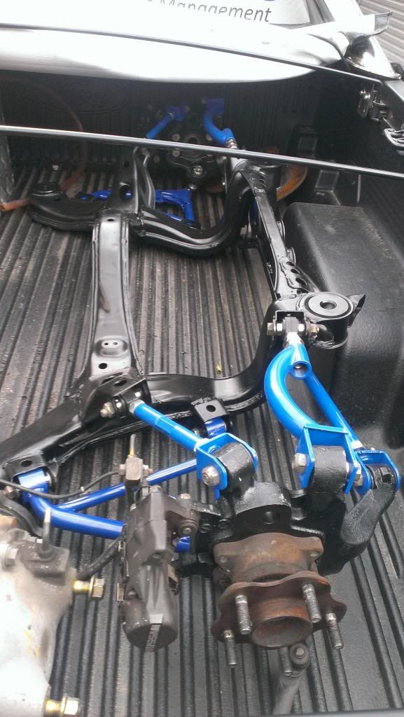

    The cradle getting a brace kit and welded where required for strengthening

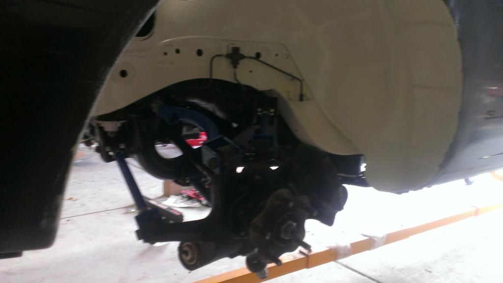

    R32 alloy uprights fitted for the rear

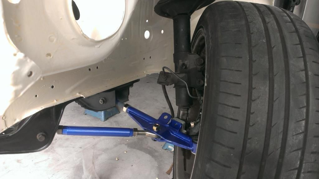

    Front and rear standard suspension arm replaced with rose jointed adjustable arms
    Standard VLSD replaced with 4.3 and new KAAZ 2 way LSD centre

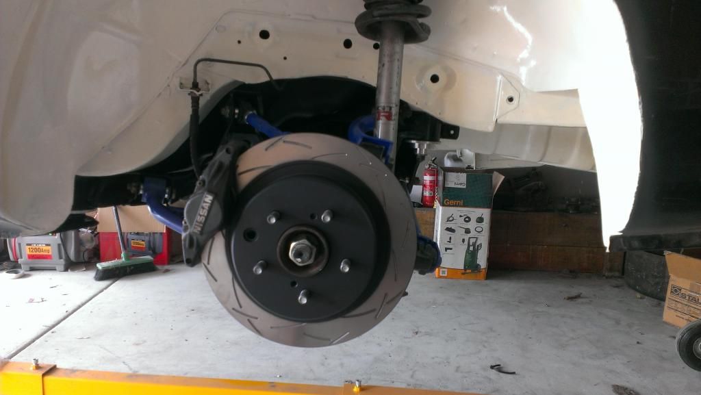

    The R33 GTR rear brakes fitted up to make life easier, and
    Solid bushes and mounts to bolt back onto the shell

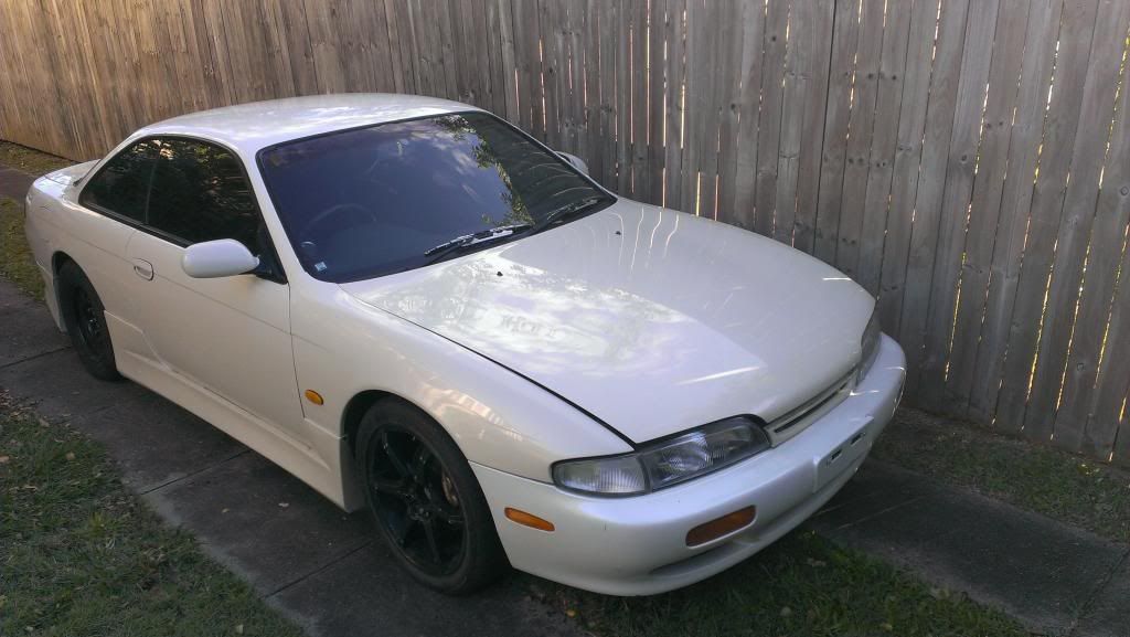

    At the same time I bought another S14 off the forum to get all the fiddly bits I would need plus the panels I needed. So to make my nopics at the time really happy, this turned up unannounced....

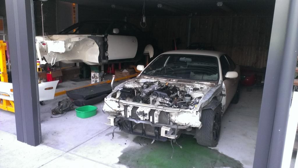

    Once I got back from Indonesia I was able to spend some time on the car, so the donor was stripped, with the interior sold, the drivetrain put in the shed and shell then sold off as well.

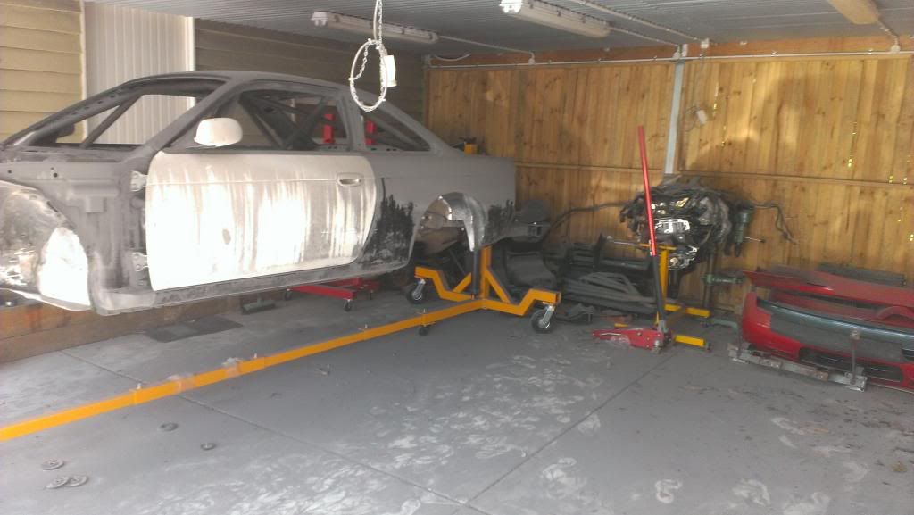

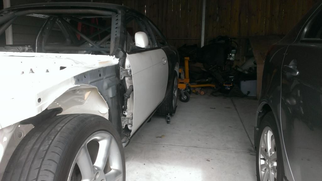

    And to make the nopics happy this is where the shell lived for a couple of months until it was sold....

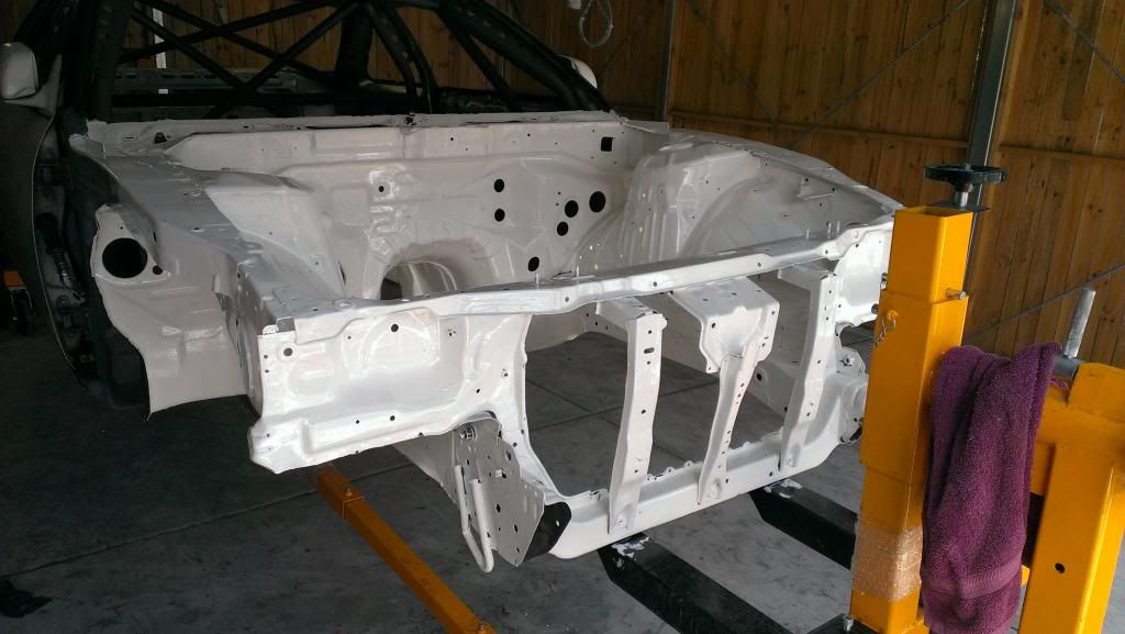

    At around this time the guards, bonnet and bootlid from the spare car were sent down to Adelaide to a bloke to make molds to produce the hanging panels in plastic. The plastic is the same type as used in the stackable green and white garden chairs and will give me a big weight saving for the car, plus the advantage of plenty of bend before they break, and if they do split can be glued back together with acetone. Another advantage is the base colour is white, and as the car will be white, no need to paint.

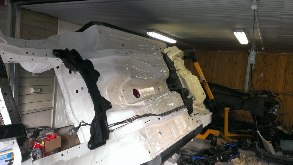

    Nearly 12 months after it went up on the rotisserie, it was time to bolt everything back in to get the car back on the ground. Fuel tank and hard lines were installed first.
    Then the fun job of installing the rear cradle complete with diff by myself. Using the engine crane made the job reasonably easy, but took a bit of figuring out to get the straps right to get the angles needed to have the cradle drop nicely onto the pins in the body.
    And all installed with dodgy beer o'clock photo....
    Front suspension was an easy bolt up to get the car on the ground again.

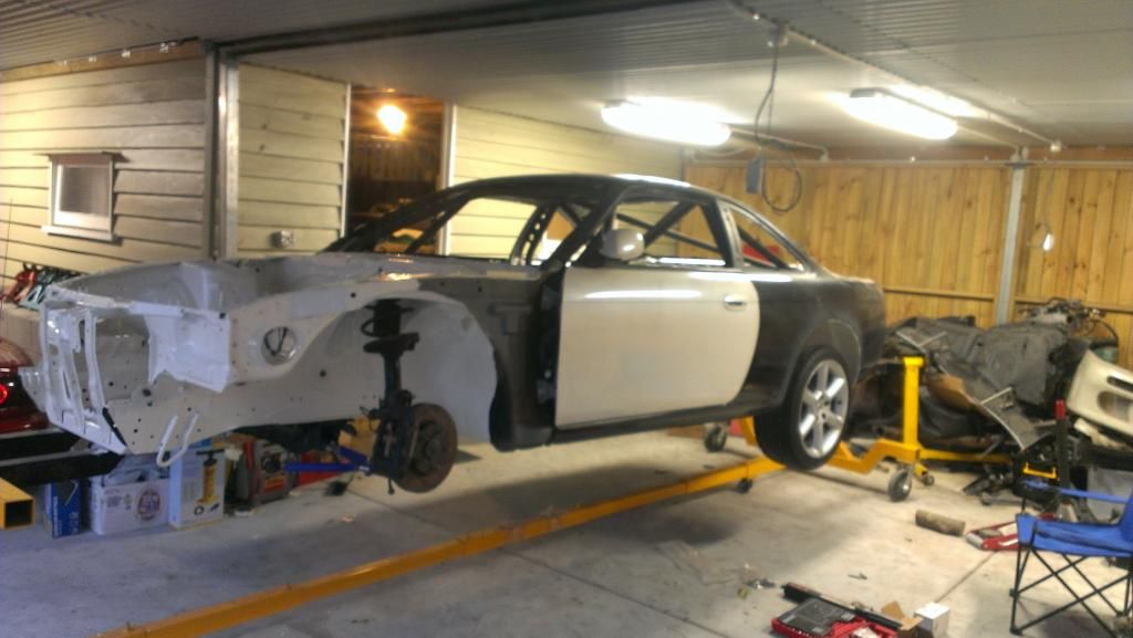

    And finally on the ground again after 12 months......
    So at December 2014 the car was back on the ground and pushed to the back of the garage where it has sat for 12 months or so.
