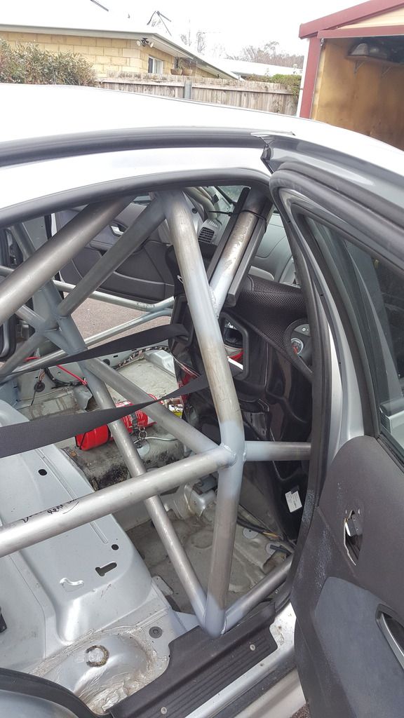

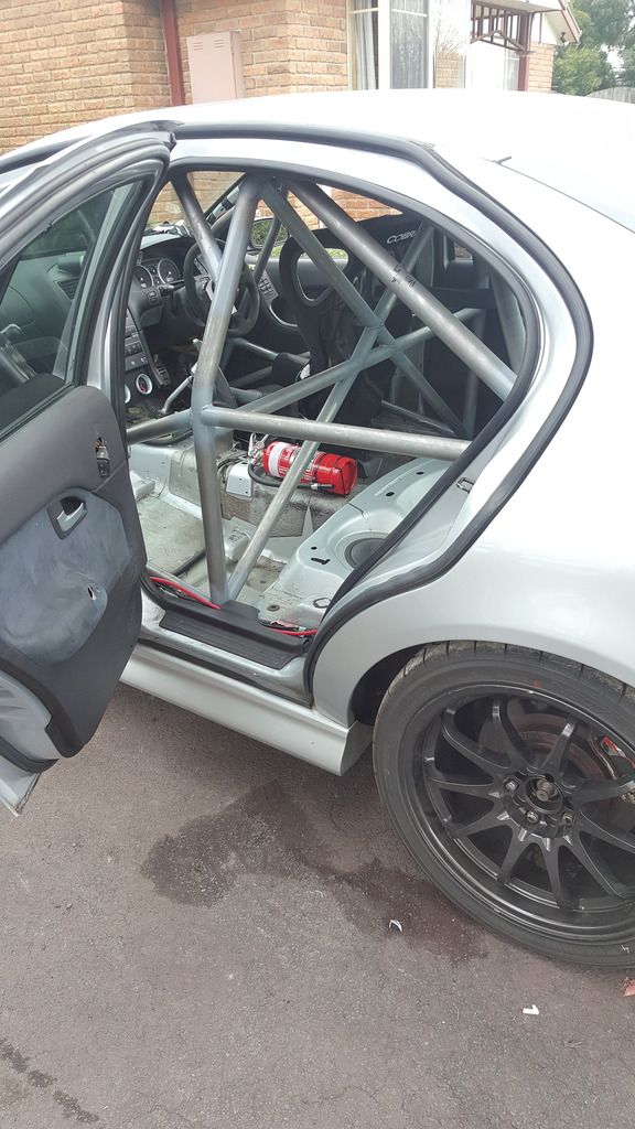

    I also bit the bullet and ordered a full cage from Bonds. $1900 delivered was cheap and a local fabricator would weld it off cheap if I notched and tacked it together. Was an absolute prick of a job due to the number of bars but it came together ok. The door bars along with the size of the seat make it fun to get in and out of but it'll have to do.

              Looks like fun mate. Shorten your belts though, you've got a bar a few inches behind your seat - use it...

                        That cage looks to be around about 60kg, give or take. You should be well ahead of that on weight savings with the stripped out interior. Weight saving is the cheapest way to improve your lap times, you are definitely doing the right thing there. Another useful thing to do is remove all the surplus brackets, get yourself a spot weld drill and go nuts. And have you got everything out from behind the dash, heater etc? Maybe not if you are going to keep it registered, but the air con could go.
