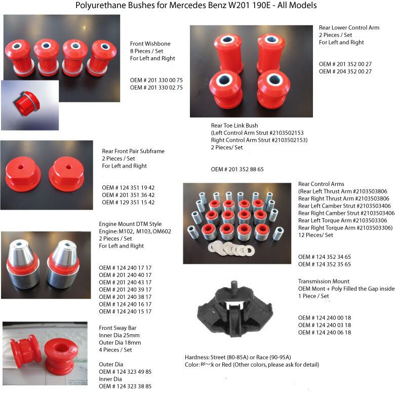

                            I've also ordered a full set of urethane suspension bushes from a bloke in Thailand who took the initiative to get a bunch made for the 190E.
                            And a set of adjustable rear camber arms
