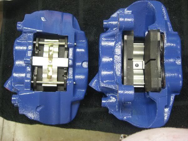

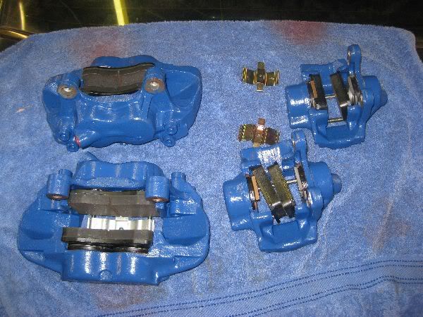

                          It dried out enough for me to be able to finish building the calipers and have a fight with the press over getting the new rear link bushes where I wanted them to be.
                            Nowhere near as much progress on my eagerly anticipated week off.
                            Brake calipers all reassembled and ready for install:

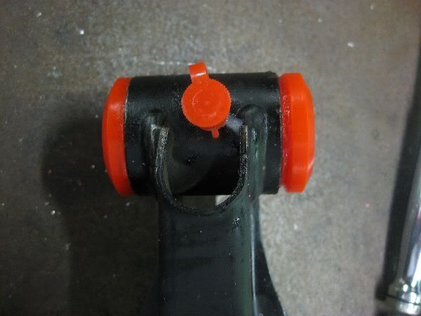

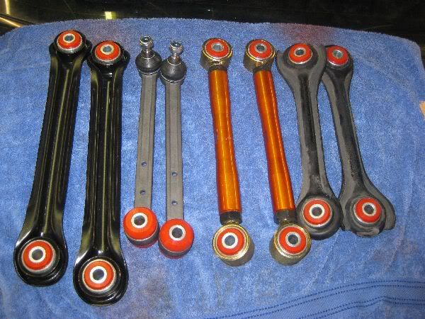

                            New poly bushes pressed into the rear suspension links:

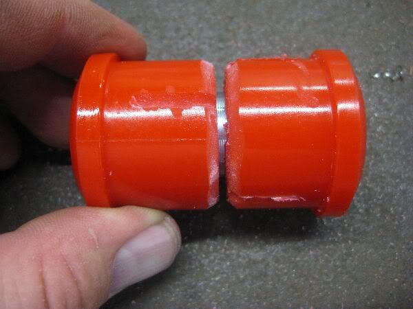

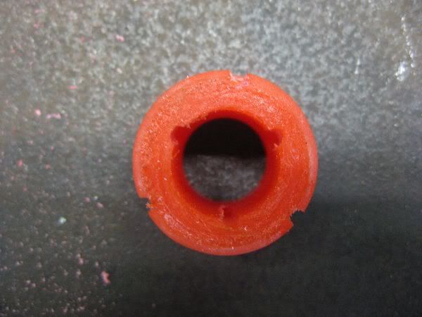

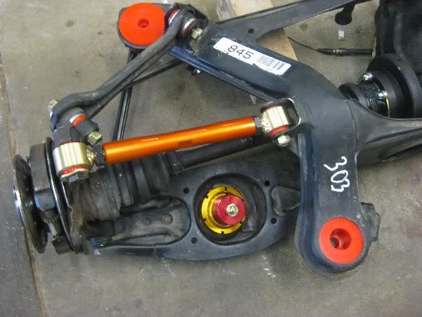

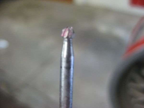

                            I did some modding of the inner bush on the rear lower control arm, similar to the front control arms:
                            If you're interested, this was the Dremel bit I used:

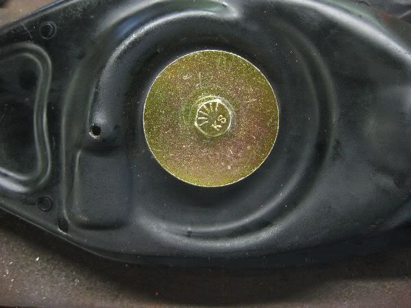

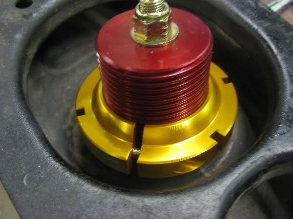

                            New rear spring perches installed in the lower control arms:

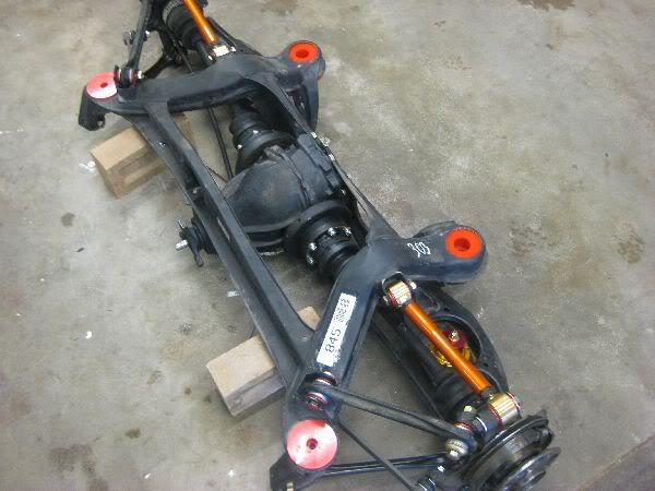

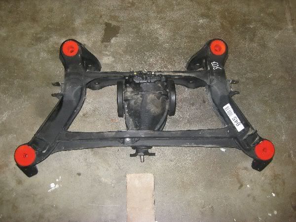

                            New subframe bushes installed and original open diff mounted for Al to work out positioning of whatever diff is going to go in (thinking R200 presently):
                            Subframe all assembled and ready for a helping hand to reinstall!

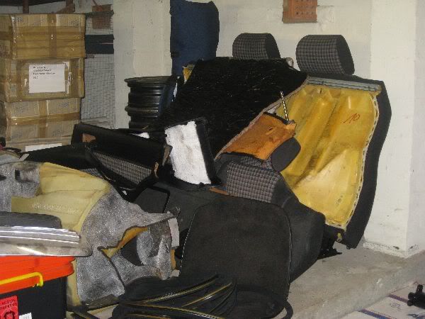

                            New interior arrived this morning - it's a big pile of bits!

                              Nothing like having a whole new swag of bushes in arms ready to re-install....
                                It could have been even easier - I bought all new arms that already had rubber bushes installed. But I had to press them out first to put the poly ones in. And being aftermarket arms, a couple of them were a bit shitty quality which is why some of the dirty original arms make an appearance in those pictures.
