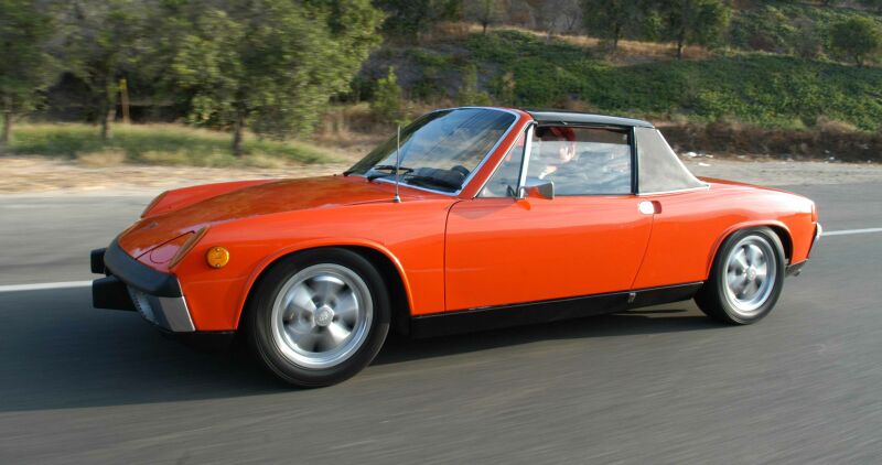

    Hopefully mine will look somethimg like this
