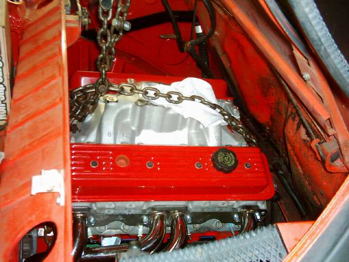

                    Originally posted by Crash Dummy
                    I'm trying to imagine what that thing would be like to drive with a current generation Subaru 3.0 H6 slotted in there :D
                    The yanks do this to them :oh:
                    914 V8 Chev...
