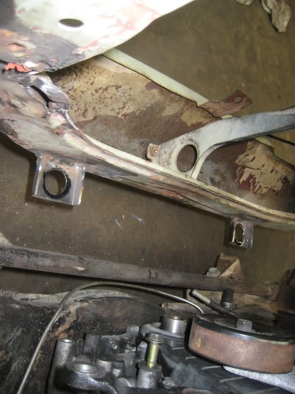

            Radiator support mounts made from some folded brackets. I got them off some truck exhaust pipe I have and welded to the rad support. I also seam welded all the cut panels back together. There is a lot of cut off bits as the original radiator only covered 2/3 of the rad support and was about an inch further forwad than the new rad.

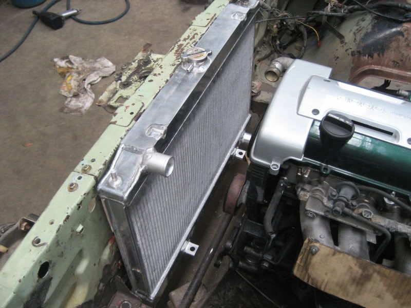

            Rad in.

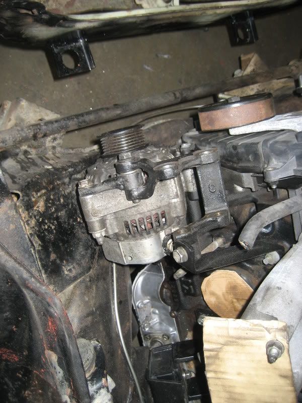

            Alternator relocated from driver side to passenger side(where A/C compressor was). Because I mounted the engine quite low and as far back as I could the alt doesn't clear the rail on the other side. Some custom mounts on the passenger side and it clears pretty well.

              Al I've never really looked in to it, but is the alternator relocation a 'bolt on' proposition? I'm assuming the PS pump still fits?
                You have to space it to the appropriate position so the pulley's align but it is pretty straighforward. Yes the PS still fits, A/C compressor may be a squeeze though.
                  A bit more done today. WRX fans mounted on the S15 raditator. They fit the rad perfectly and there is enough clearance to the pulleys albeit not a lot at the water pump pulley.

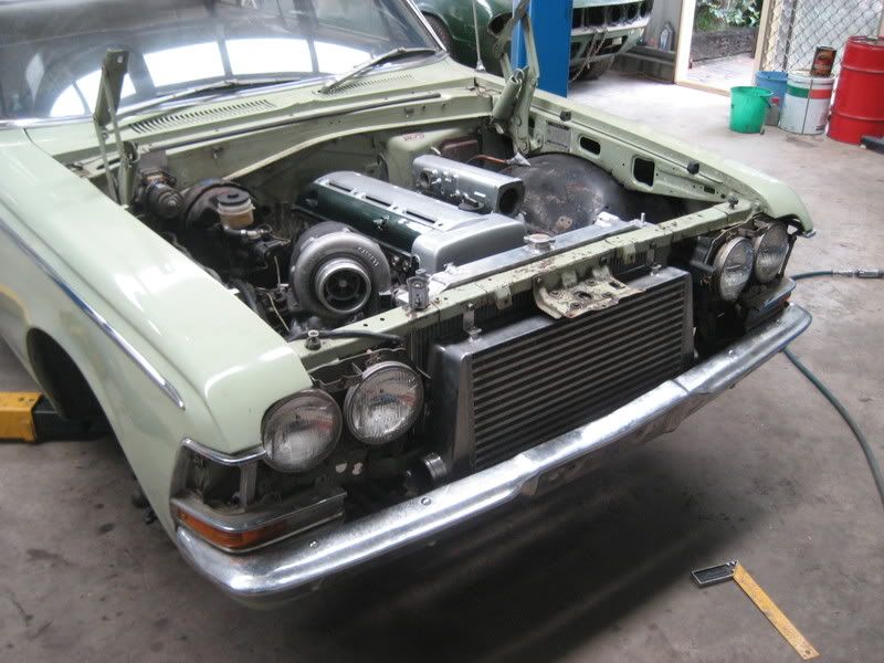

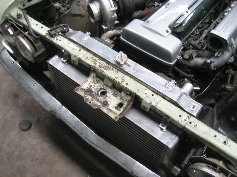

                  Got to work on finding a spot for the intercooler then, there's no ideal spot so I decided to go up high with it in an effort that it can be well hidden. It's just hanging atm, will solid mount it at the bottom with welded on brackets(to the core) to stiffen it up as it will then hold the bonnet latch plate in place.

                      The Crown is coming along very nicely.
                        No firm ETA till skids, work progress will slow markedly once I go back to work on the 12th.
