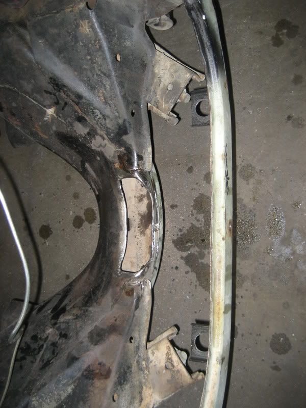

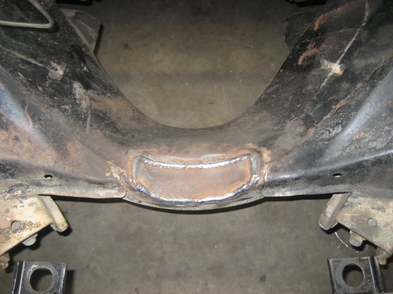

            I pulled the engine back out last weekend to fix some rust in the front of the chassis.
            Cut out the rust spot and welded in some new plate. Imagine how thrilled I was when I found that the harmonic balancer now cleared the chassis. Cool.

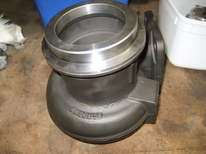

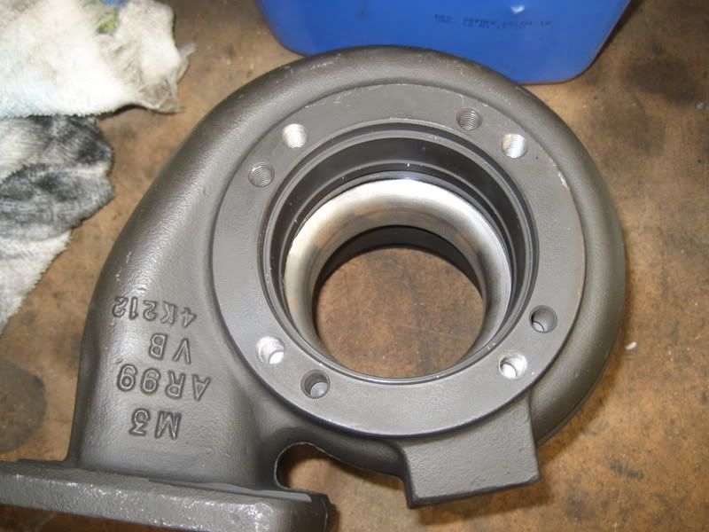

            Also had the turbine housing off and sent it to a mate to redrill the core mount holes to suit the housing orientation on the 2JZ and had a V band flange machined up to mate to the housing.

              Love the rust repair lol.
                Damn Rust, scourge of the classic car owner.
                I reckon some small hub caps and whitewalls will do me. Got a number for a guy that does whitewalling but the tyres need to be used first.
                  Odd how it rusted just there. Is that a common problem on old cars that are getting a different motor? :p
