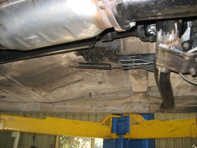

          Here's a shot of the floor where I could mount it.

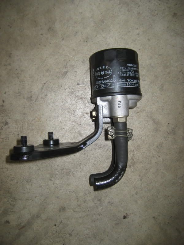

          Here's a shot of the subaru spin on auto filter. Should be handy on my fresh auto. Stints 2JZ eats auto fluid for brekky even with Transmax Z in it so regular changes plus a good filter should help.

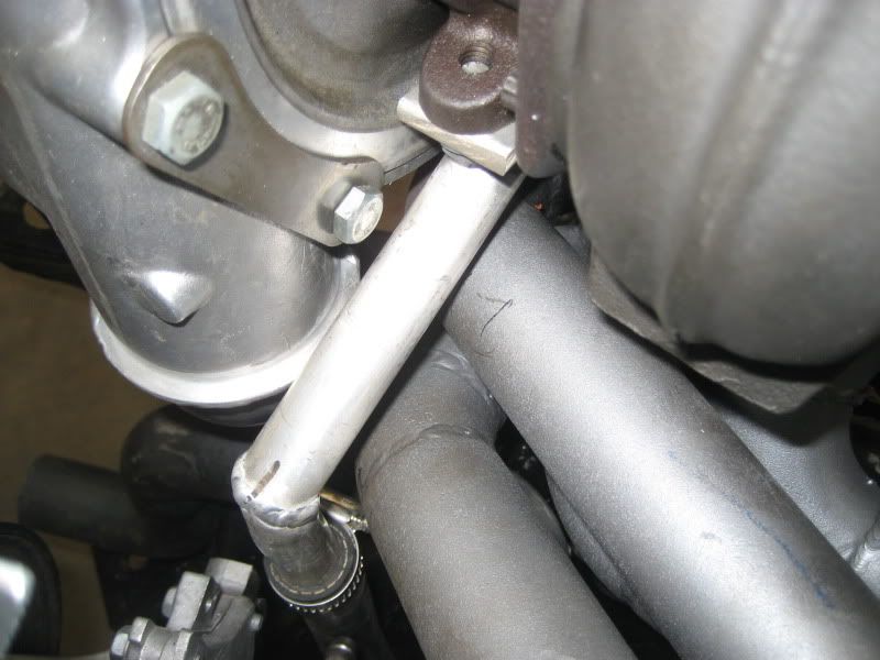

          I also did the oil drain for the turbo. It's a bit ghetto but will do the job ok. 20mm alloy tube from the turbo into some parker hose and then joined to an R33 skyline 45deg hose into the sump outlet. I wanted a 90 degree but this is the best I could do. It's pretty tight around the core because of all the runners coming in at odd angles.
            Just stick it up under there and I bet it's fine- do you have a temp guage for the tranny?

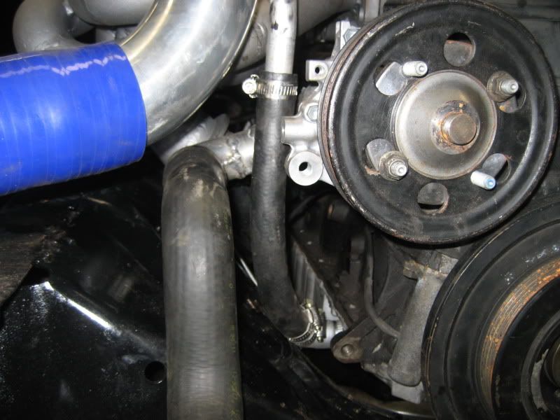

            PS What's the story with the water pump pulley?

                  Whats that auto filter from exactly??? Never seen one before.

                      The oilt filter is from 99-04 Liberty Legacy B4 turbo and H6 cars. It's hidden inside the LH inner guard. Other models have it mounted directly to the gearbox but the turbo and H6's exhaust design fouls it so it is remote mounted.
                        Muz, the water pump pulley is a modified hydro pump pulley, It's had the spline drive milled out of the centre and the bolt holes for the conventional pump drilled into it.
