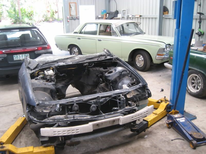

            Got an Aristo half cut instead of the usual engine/box/ecu. Cost the same and I thought the spare bits might come in handy on this one. Might try and use the front brakes too.

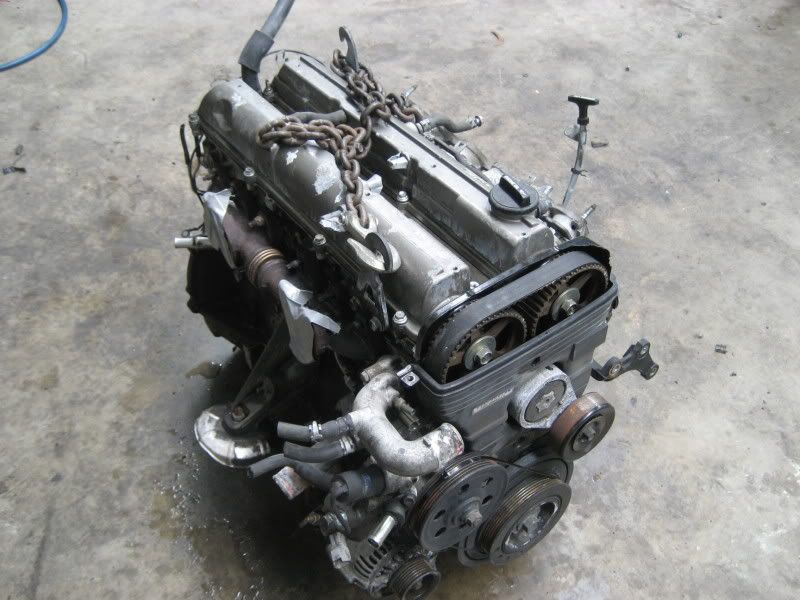

                          Got JZS147 half cut last week and pulled it to bits yesterday. Look all good for 115k km. Got it all stripped down to the long motor so I can change the sump, strip out the engine harness of unnecessary wiring and toss the ghey twin turbos in the bin.
                          Empty halfcut waiting for unceremonious dumping.
                          2JZ eager to overpower feeble old Crown.
                          First time the shed has been used in 8 months. I dirtied it up good. :D
