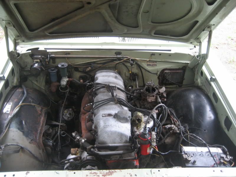

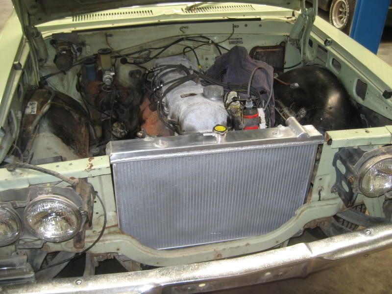

                      Just about to pull the old engine(just having lunch). Just been cutting the radiator support to bits to allow easy fitment of the engine and accomodate the new sized rad.

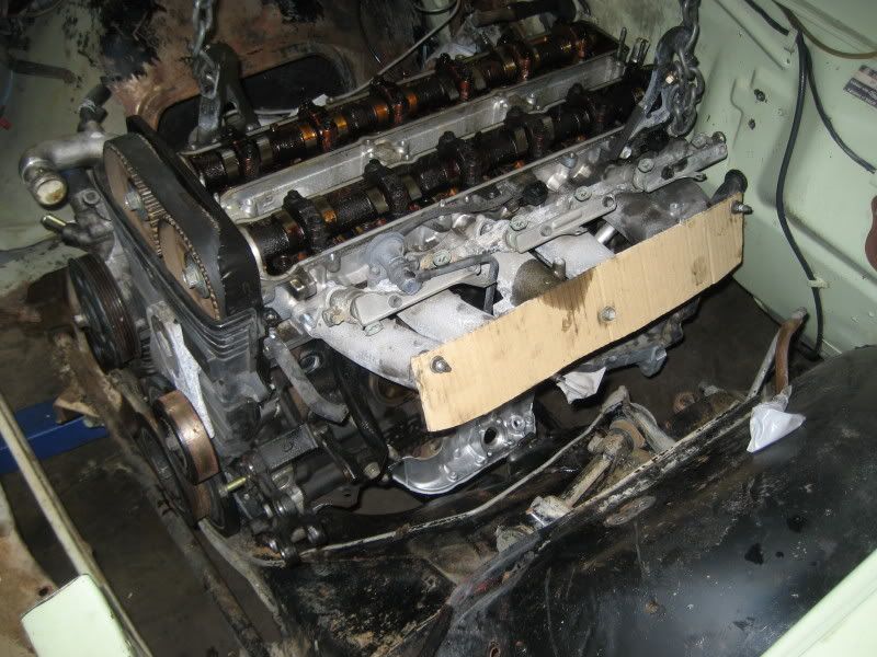

                        Pics of progress.

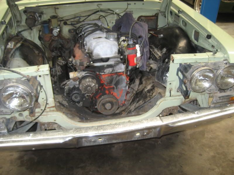

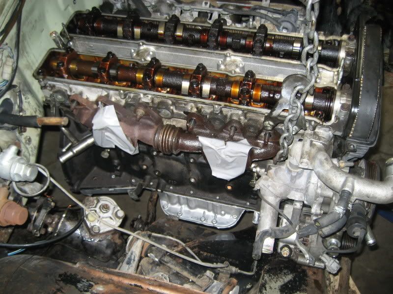

                        Pulled all the ancillaries off the engine(not many) and unbolted everything ready to pull out. Then cut out the radiator support to accomodate the larger radiator planned(S13 or R32) and allow easy fitment of the engine and box. This is a godsend when you have to pull it out a half dizen times to get the mounting right.
                        Old Donk.
                        Cut out rad support.
                        S13 alloy rad for test fit. Fits nice.

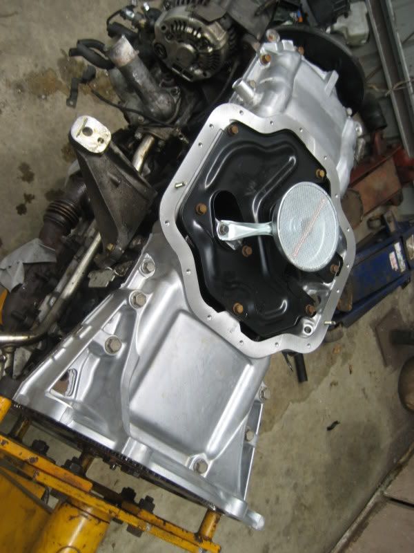

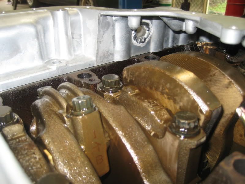

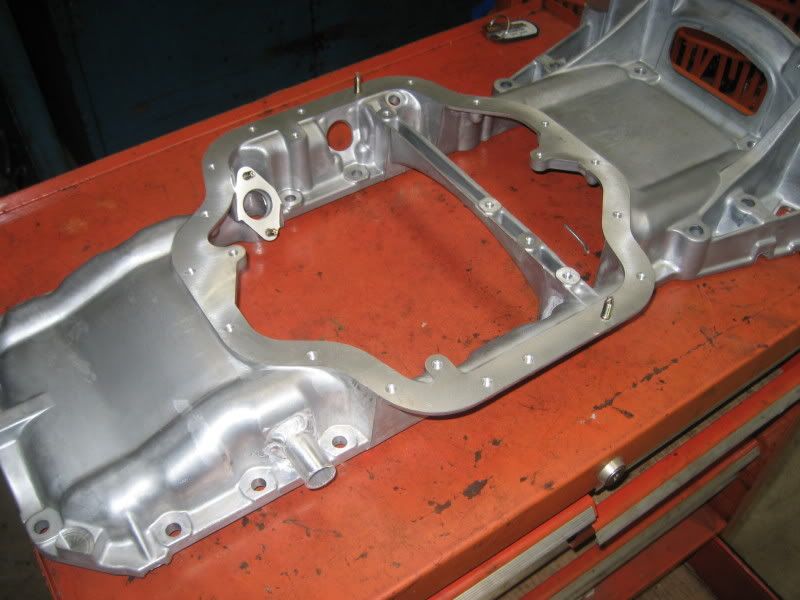

                        New JZS131 sump with oil drain welded in.
                        Fitted to engine.
                        All the other new bits bolted on top.

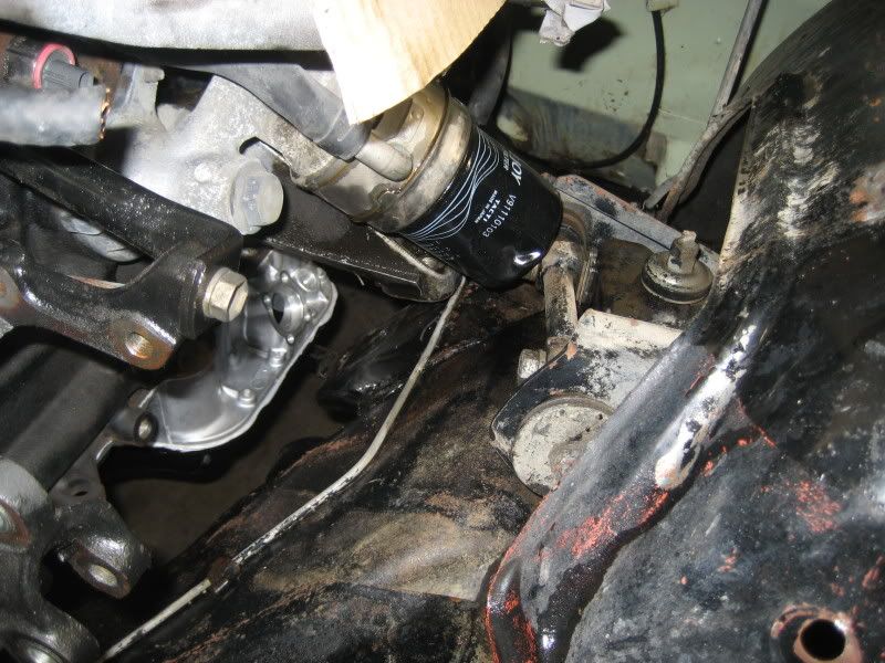

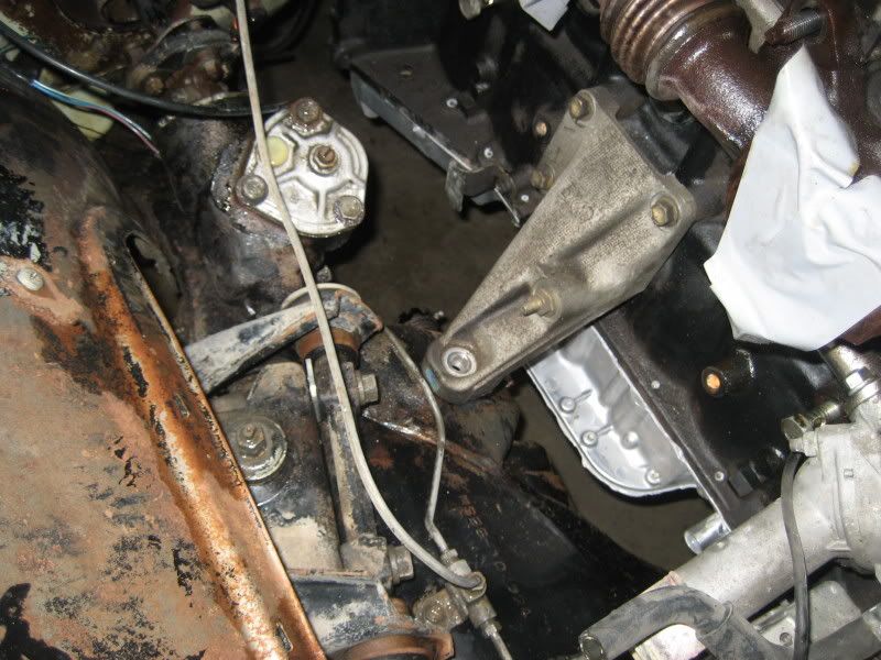

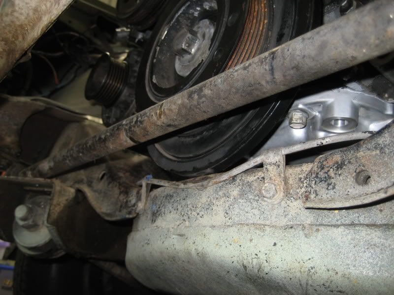

                        Threw the new donk in to see how everything sat. Was considering using the alloy toyota block brackets and welding new mounts to the chassis. Can't do it, completely wrong shape. The oil filter also fouls the suspension so will have to swap for a soarer filter housing that points upwards.

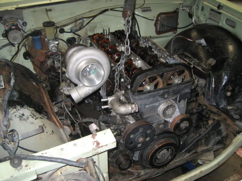

                        Pulled it back out and ripped all the brackets and other shit that won't work off. Threw it back in with the angle adjusted and got it sitting in a reasonable spot.

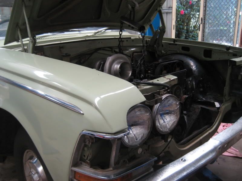

                        Good clearance evrywhere except...
                        The large front pulley fouls the chassis and/or swaybar. Will ask some crown experts what they did with there conversions but am thinking of sinking a relief into the chassis to accomodate it rather than move the engine to another position or raise it.
                        Obligatory gratuitous turbo mockup shot.
                        Got a bit done in between looking after a 6 month old and sweating my arse off.
                        Also took a heap of measurements of the diff and front hubs to research brake and diff options.
