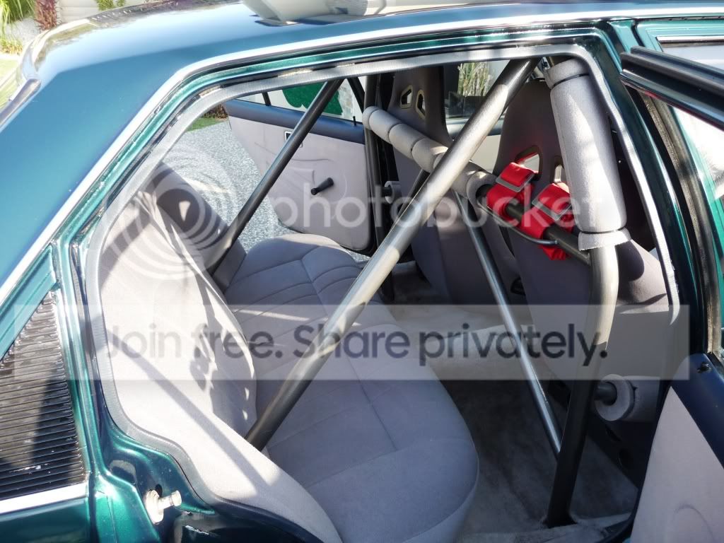

              your cage is exactly how i had mine in a vh i had, got the trimmers to cut around the cage and keep the back seat, see if i can find a pic

                        not exactly the same, but you get the idea
                        the bar running to the back seat went right where the adjustable top arms bolted onto the car
                        those noltec adjustable top arms are a must for the power you'll make
