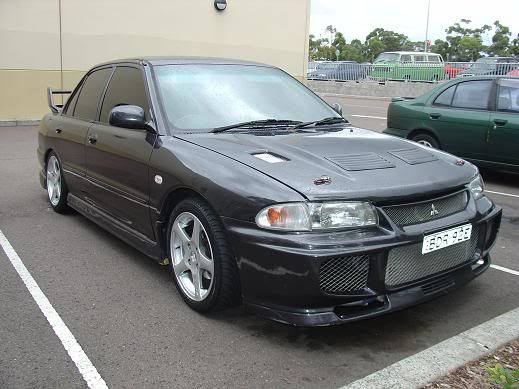

    Thought i would post up my new ride.
    I have sold my supra and got this.
    1994 GSR Lancer
    Specs
    Charcoal/gun metal grey
    5 speed manual
    Full evo 3 body kik
    Rebuilt gearbox, transfer case and tail shaft
    Tail shaft has custom centre cv and bearing
    Haltech E8 stand alone ecu with 3 bar map sensor and in car boost controller (select high/low and every number inbetween)
    Haltech 2 step launch control
    Gizzmo DSII-L shiftlight
    Engine: fully built 4G63-T
    EVO block - crank, flywheel, pressure plate, rods, pistons and rings, crank pulley full bottom end balance of rotating assembly to 0.01g, acid dip and surface grind bored 20 thou over, cracktested and micropolished and linished crank.
    Wiseco pistons
    Eagle rods
    VR4 Big port head
    Hypertune intake manifold
    Hypertune 3inch throttle body
    Custom steam pipe manifold
    Garret GT35R fully rebuilt and ceramic coated
    Tial 38mm external wastegate with screamer pipe
    Sard fuel pressure regulator with gauge in engine bay
    Brian Crower Race Camshafts 280/280 intake and exhaust
    Titanium valve springs
    Titanium retainers
    HKS cam gears
    Gates racing timing belt (brand new)
    K&N pod filter
    Braided hoses and earls/speed flow fittings through the whole car
    ACL Tri-Metal Race series Main Bearings
    ACL Tri-Metal Race series Rod Bearings
    Fel-Pro Gaskets
    Cometic head gasket
    ARP Main Studs
    ARP Harmonic Balancer Bolt
    ARP conrod bolt
    LS1 coils on custom aluminium bracket
    Magnecor High tension leads
    Genuine Ralliart oil cap
    Peterson Fluid Systems custom catch can
    4 row aluminium radiator
    Full 3inch exhaust with high flow cat and big cannon with 5inch tip
    Fidanza Lightweight Flywheel 3kg
    Custom front mount intercooler setup
    Twin 12 inch Craig davies electric thermo fans
    Engine was built to rev to 9000rpm+ reliably all day everyday and can
    Sard 700cc injectors
    Walbro 550hp intank fuel pump
    Bosch 044 700hp external
    2L surge tank
    2 x fuel filters
    Tein Super Street coilovers – height and damper adjustable
    Cusco camber tops
    Cusco front strut brace
    Ralliart and nolothane bushes through the whole car
    Front guards rolled and pumped
    Rear guards rolled and pumped/flared
    Made 370AWHP @ 18 psi
    Hasn't run on the dyno at hi boost (approx 1.7 bar)
    I have only driven it on low boost. Is a bit on the laggy side not making boost until 4200rpm
    It really gets going by 5500, and stays strong til redline - 8750rpm

                OK so update
                manifold is off new wastegate is ordered.
                It had a real major issue controlling boost with the 38mm Gate.
                So i ahve ordered a new Tial MRV (water cooled) Gate and the manifold is getting modded to help the gate flow better as its current design is a bit restrictive off the collector.
                Once that's done off to get HPC coated then strap it all back on the car.
                I have already modded the intercooler and piping, re routed the alternator wiring, put a 30psi boost gauge and fixed the alarm.
                Now is running a 4.5 Inch varex Muffler and the front half of the exhaust is also getting HPC coated.
                Also put the stock shocks and springs back in it until i get the tein springs that arnt solid lol.
                Next thing after tune and power cruise is to get an evo interior (recaros) and touch up the body.
