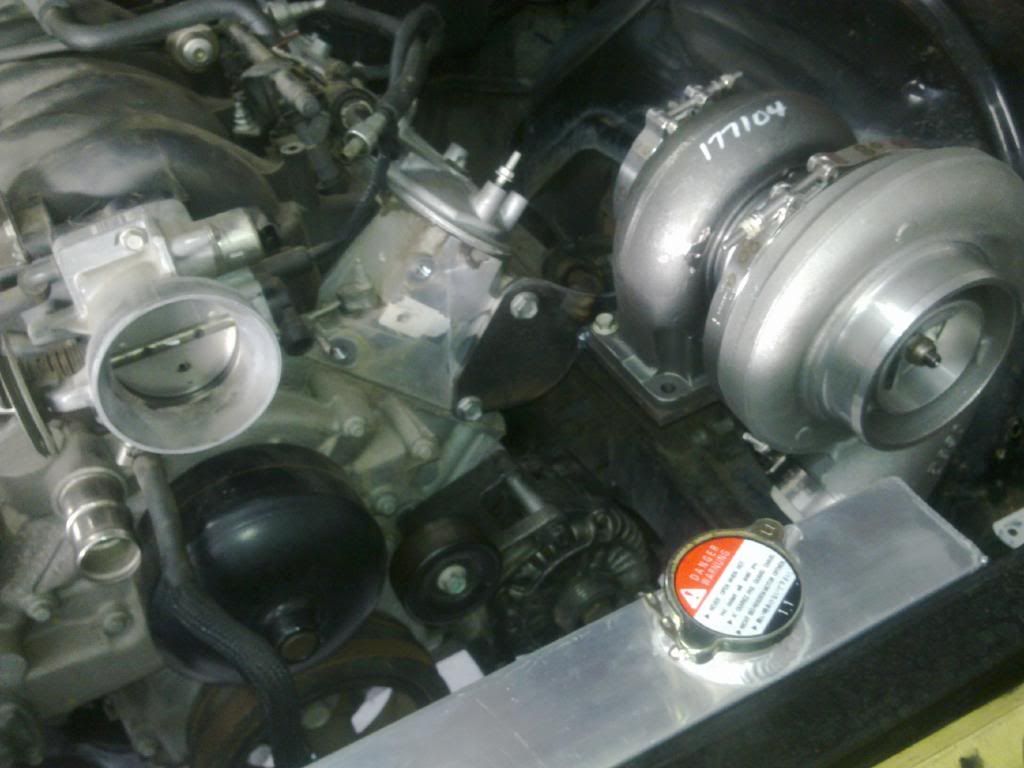

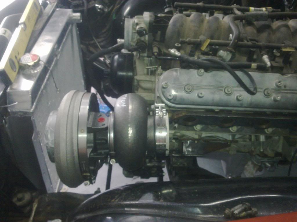

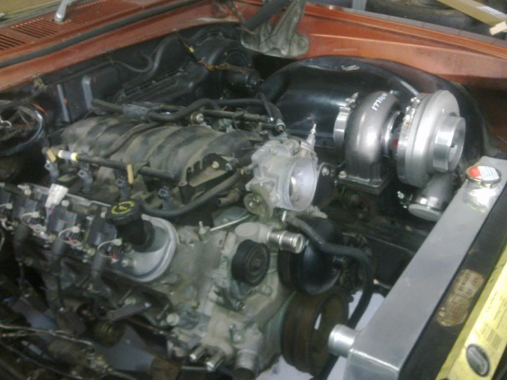

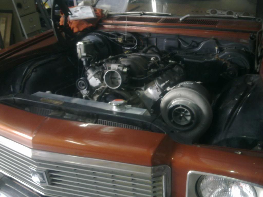

    Got the HJ off a local bloke and have had it sitting in the shed for a while, finally decided on a LS1 motor instead off a 355 originally. Using a TSI powerglide and eventually fitting a 9" .
    Plans are new rods/pistons/valve springs. then skids
    Fabricated the engine mounts myself using the original rubber V8 ones, and used a colorado H3 sump instead of paying $1100 bucks for a CAE or similar one.
    Next on the list off things to do is the turbo manifold, will be a log style made out off 40&50mm NB pipe and butt weld fittings. And intercooler pipework out off 75mm aluminium pipe.
    Few pics, this is as far as I have got.
    Excuse the shit mobile pics and dust.
