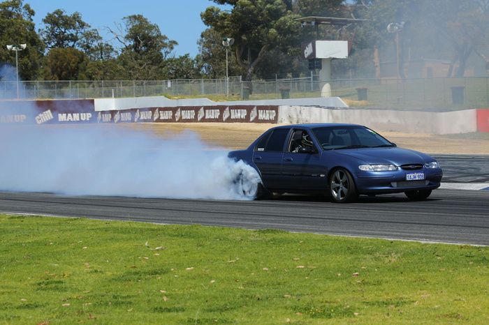

              yep powerglide in and running just before powercruise that was on saturday
              powerskid pics

                  Love the first skid pic. Nice shot.
