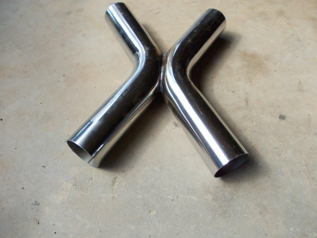

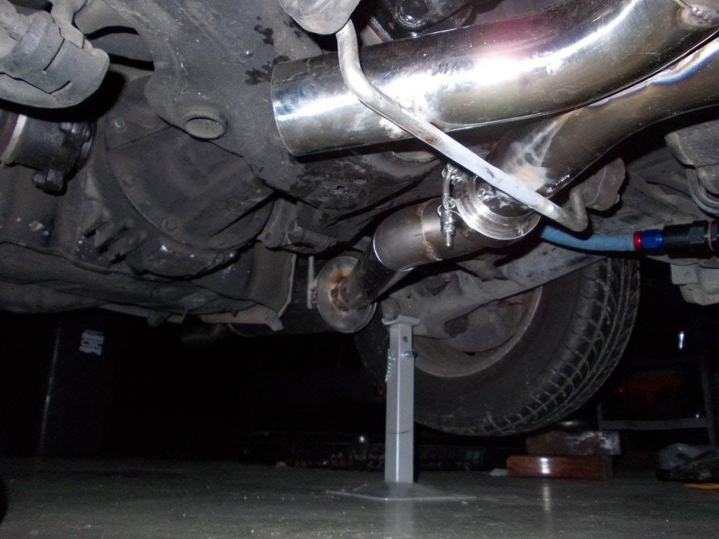

    Changed the exhaust layout the way it was it was hanging a bit too low so revamped the whole system.I flipped the cross member around as well . Also had a few issues in trying to get the Mazda OEM fuel pump relay with the PCM and is show no fucking care to work so will be fixing it with a after market relay and a dedicated pump power wire.

          Pipes look huge under there.
            Agree Muz surprisingly there is more room then I thought there would be their 2 1/2 can`t remember if I`ve said that before. I`m happy that I changed them, there's been a bit of attention to modded cars up here at the moment.
            Here`s a few more pics of exhaust
