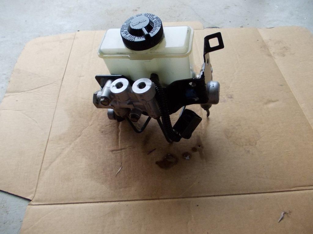

        Did an upgrade yesterday on brakes with a 929 booster and master cylinder. The master cylinder has a 1" bore and the duel booster is a duel 8"9" . The upgrade fitted well with only minor mods to strut brace. The reason I change the set up was the std Mazda 15/16 and 8" booster was with that Oem set up the pedal was long and minimal feel and was basically shit. With the upgrade it has short pedal and a heap more feel.

          Quick update brakes are excellent now , steering rack could be better ( have other one to put in ) . Going to tuners early new year (Matt Spry) for a check up cars running rich . Then will go to test & tune & Lakeside. Over all very happy with car .
