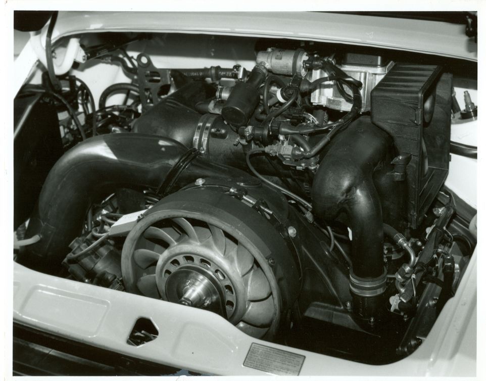

                              Here's an interesting solution
                              Carrera Cup cars did away with the heater blower, and just had this bypass pipe instead Apparently there's still plenty of heat, just less airflow (and rpm-dependent airflow at that, since it's the engine driven fan that pushes the hot air into the cabin!). Saves 4kg and de-clutters the engine bay
                              This RS heater bypass pipe is available and isn't that exxy I spose .
                                I would be tempted, but I can see fan speed varying with rpm as getting very annoying on a daily.
