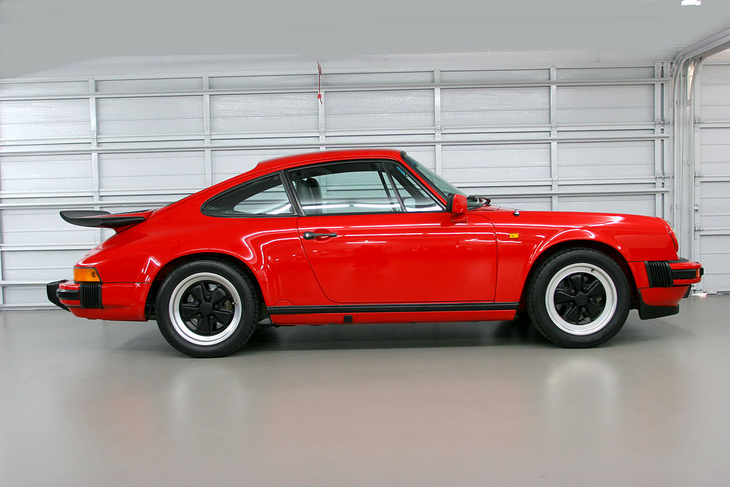

                          Dunno if the ducktail works on the 964 shape. Maybe with lots of mods but on a stock looking car IMHO it doesn't work
                          I do like the RS America whaletail tho (and I am thinking about the Carrera script in blue)
                            RS America spoiler looks suspiciously like Porsche getting rid of left over 3.2 parts.....

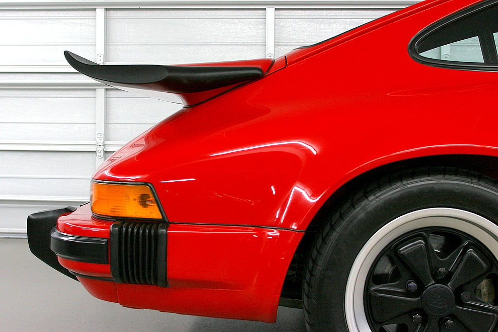

                              detail shot
                                I'm not 100% sure if it's exactly the same....On Rennlist they fight over second hand RSA whaletails, and then there are guys who fit fibreglass replicas. Not sure if I've ever heard of a guy who put a 3.2 whaletail on.
