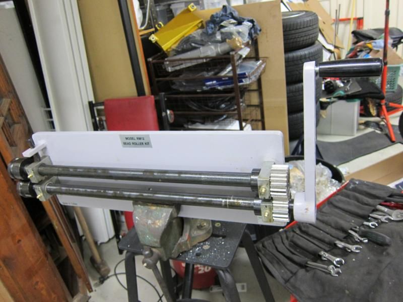

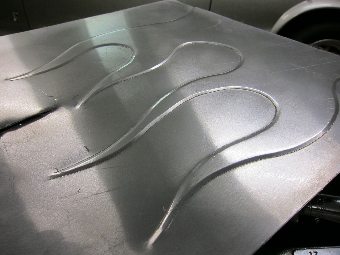

                            It was going to be a really nice bracket too...dimple dies and I was going to bead-roll a lip into it. But the sender would have had to be at a 45 degree angle and upside down to fit in that space
                            Beadroller is a new toy
