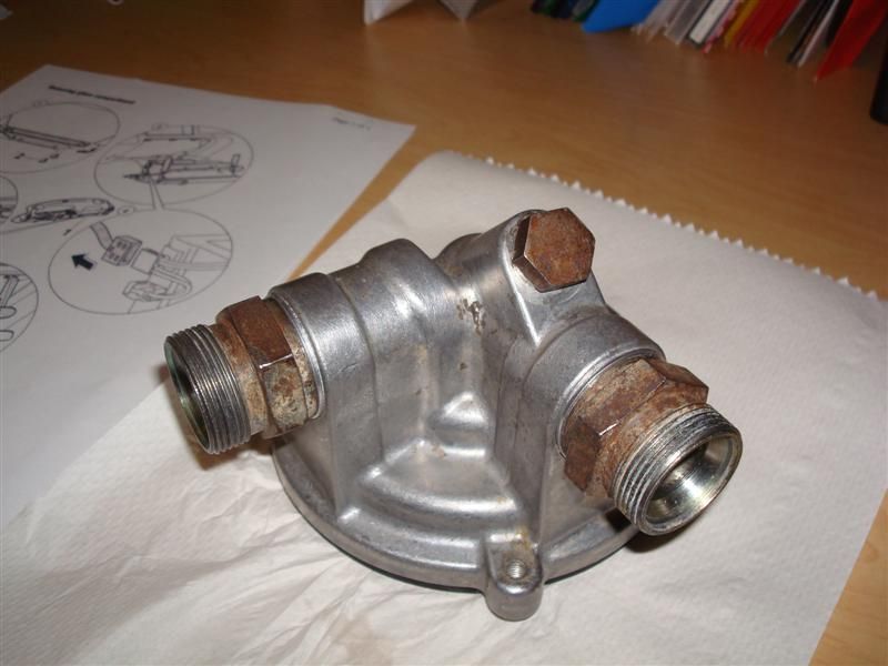

                              Question, fellas.
                              I found a pic of a dismantled oil filter housing (where that leaky pipe bolts to) and it looks like there isn't a crush washer at that leak point after all, but rather it's a tapered fitting. It doesn't look like the industrial kind of compression fitting I'm used to tho (where you flare the end of the pipe).
                              There's a crush washer between the hose adapter and the housing, but I reckon that's not the leak point in my case.
                              So the question is...can I just loosen and retighten that hose fitting, or is the taper surface rooted/corroded once it starts to leak?
                                Surely the corrosion wouldn't cause a tapered fitting to leak as it would just be between the threads (i.e. surface corosion)?Probably a bitch to undo though!
