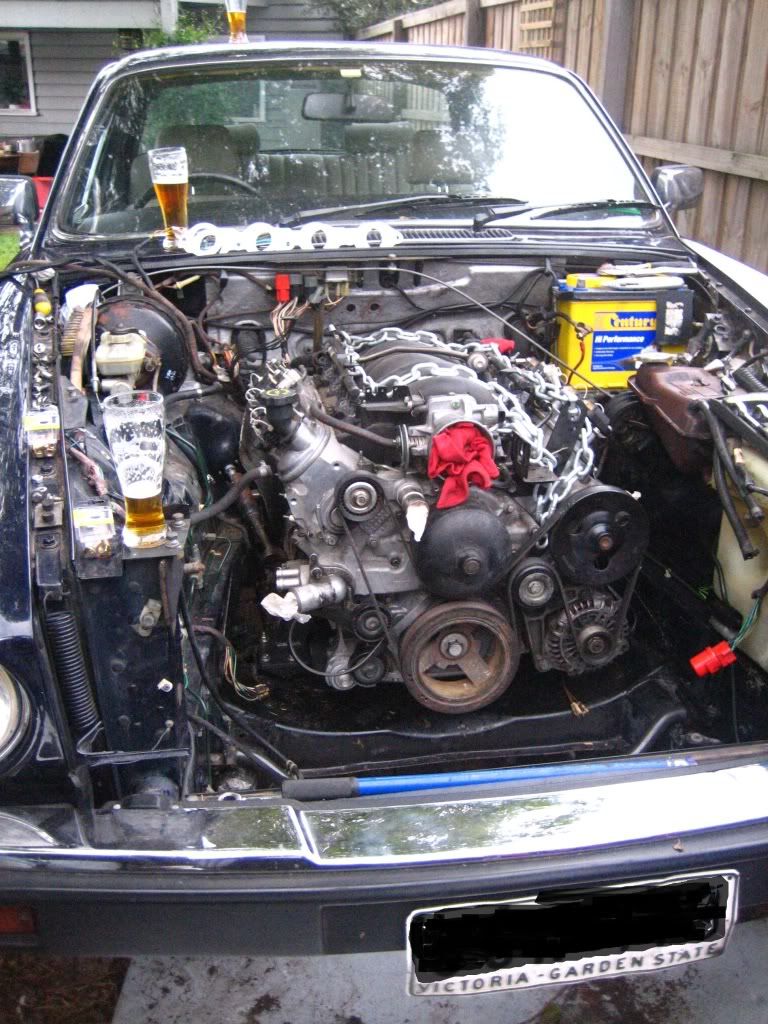

    And the LS1 fits great! It's I think a stock VU motor but who knows as the dodgy ebay twat that sold it me has gone off radar now. I do know it had clean oil, auto fluid was clear, it starts easily but won't run till I get the VATS off. Bit noisy with no exhaust, bare manifolds!

    I'm using a VX radiator with the Jag header tank in stock position, trying to keep to as many standard parts as possible.

                Love the fact you kept hydrated while doing the swap, judging by the above pic :D

                    It's pretty squeezy for the manifolds though.
                    I'm using a pair of right hand side 2006 Corvette cast iron manifolds - this gives enough room around the steering column where the exit has to go forwards from the flange. All the commodore exhausts head back - would hit the rack.
                    I've changed the sump to a Camaro one, rear hump, with a new pickup, a few chops to the baffle. Sump needed a small nip to clear the rack still.
