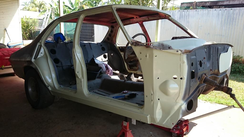

        stripped and epoxy primed the RH doorjamb - this is a job I have put off doing since the last doorjamb.. what a PITA. Protip, get this done by a blaster if I ever rebuild another car again.

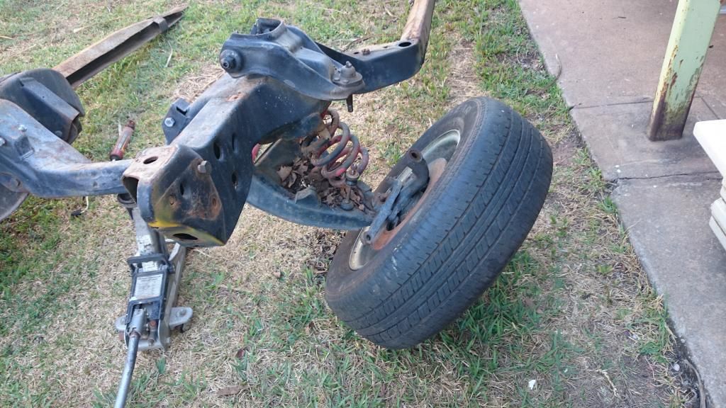

        made a spring compressor tool - ghetto but it works.
        disassembled the front. yewww! fun times.
        onwards and upwards, RHR quarter next...

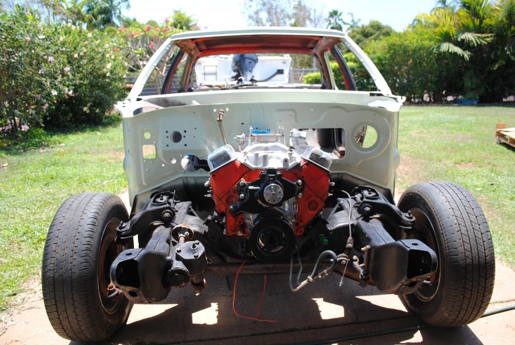

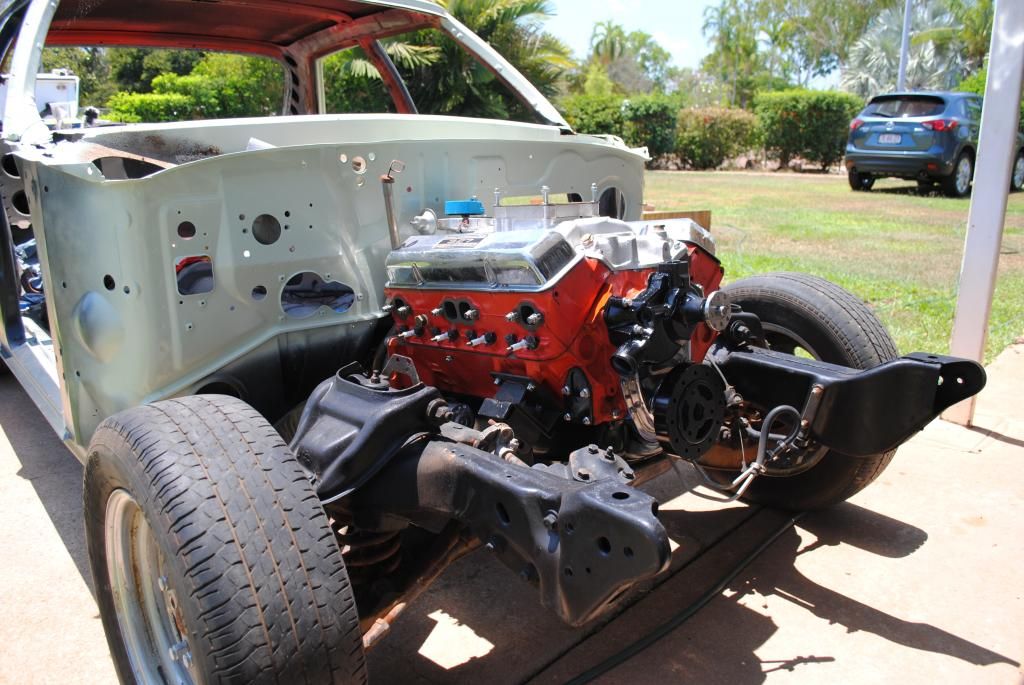

                                plonked the motor in today as we're doing some reno's around the house and needed to consolidate everything back in to one package too, thats just in the temporarily.
                                edit: oh and for the trainspotters thats just a temp. chassis under it too, a late HX with RTS, but just under it until have the HQ one blasted and painted.
