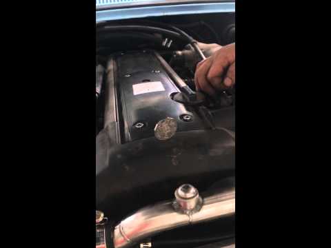

                            I don't know how many times I've said that I'm close to finishing this but it's almost ready for a test drive!
                            I replaced the water pump, fitted a bleed to the radiator cross-over pipe, and fitted the bonnet. There's a bit of extra bracing that needs to be done to stiffen the bonnet back up but everything is oh so close now.
                            I even gave it a wash!
                            I can't get over how smooth this engine is...
                            Can I wear the Scream mask? The mask from Scream... when I do you from behind...
                              Very good. Do a skid.
                                Sooo..... I took it for a test drive but no skids. The tailshaft is just touching the tunnel when the car squats under acceleration so I need make a bigger tunnel extension. The rear springs are also soft as buggery which isn't helping.
                                I've also got some pretty serious concerns about the front end geometry. It hasn't had a wheel alignment yet but I suspect bump steer is going to be a big issue.
                                I guess this stuff was to be expected!
