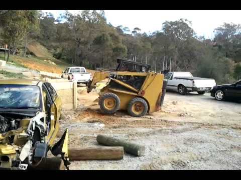

              And here's the donor car..
              Engine wasn't damaged in the smash...
              More to come...

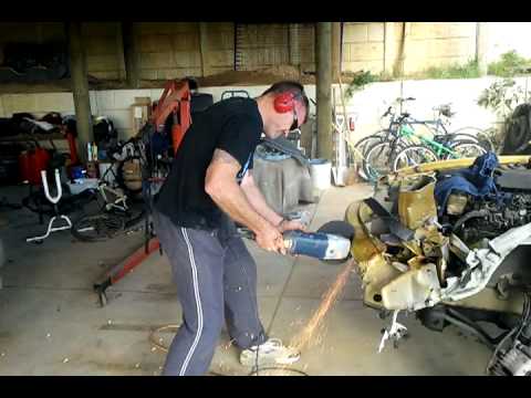

                Taking the engine out of the SS...
                  And some more idiotic shit...
