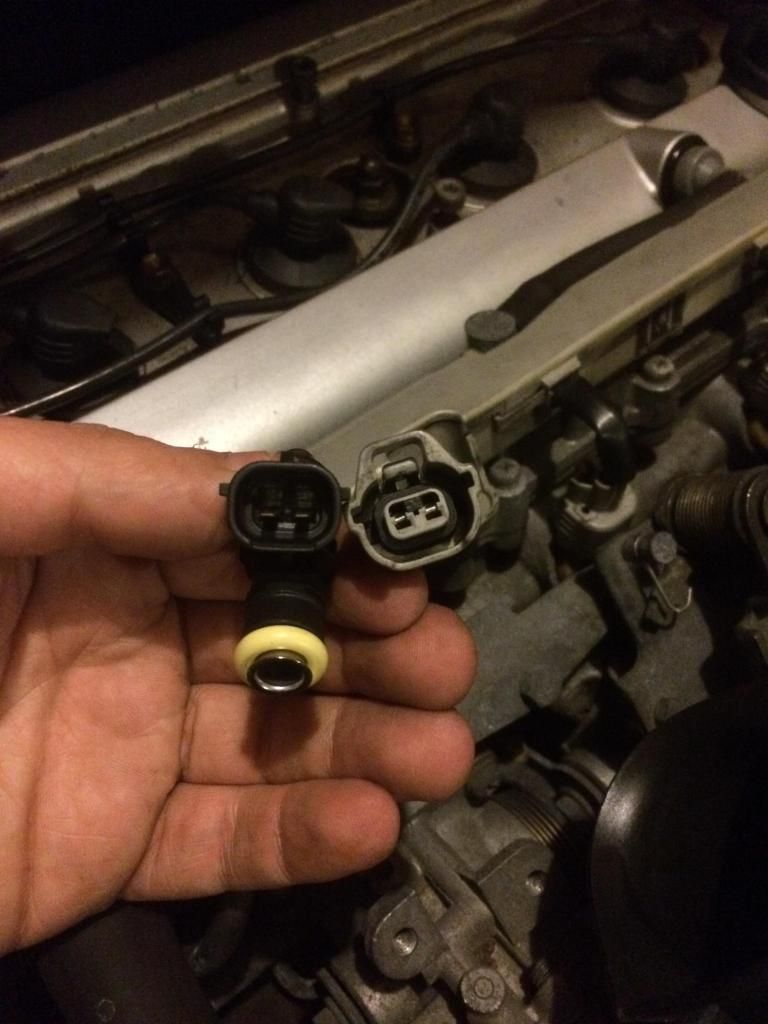

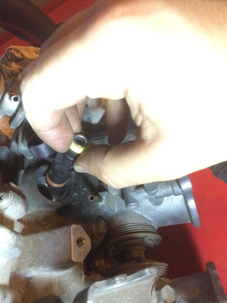

    Had a cursory look at what will need to be done for the fuel system tonight, starting with the injectors. One small victory, the 20v injectors use a later denso style plug which is the same as the ID2000s I have, so at least I won't have to fuck around with new injector plugs
    Unfortunately some work will need to be done for them to fit on the manifold LOL. All good though, I was expecting this after having spoken to baz about his setup

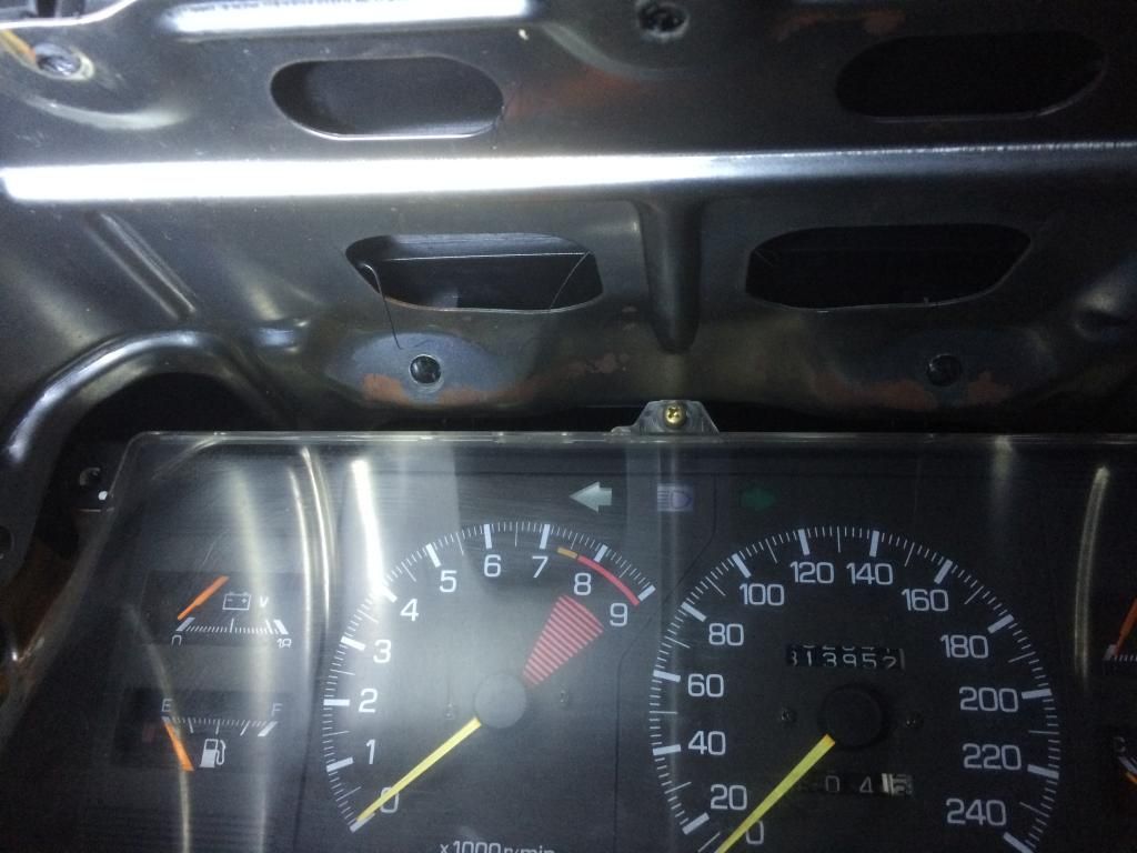

    So then I got cracking on the dash and logger. Got about halfway through ripping the car apart when I suddenly hit a snag. One of the previous owners/mechanics has decided that the best way to fix rattling dash pieces is to permanently sikaflex them in. Great foresight there, the instrument cluster cant come out unless i unbolt and remove that big steel frame, but you can only unbolt the steel frame if you take the black plastic cover off first. Which I now can't as it is sikaflexed on....

      Changed my mind after having a think. Attacked the dash with a heat gun and was able to soften up the sikaflex enough to pull it apart
