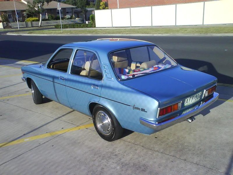

78 Gemini Sedan
    78 Gemini Sedan

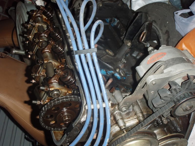

    Which is no good if you expect to be able to get to work that’s for sure. Dragged the old G161z and auto out from the corner of the garage, through the auto in the bin and pulled the head off.
    Head was fucked, 3 out of 4 inlets leaked and 4 out of 4 exhaust valves were munted. So new valves, recut seats and it came back looking like this. Slammed some Crow HD springs in there and a mild turbo grind cam [wait wot?].

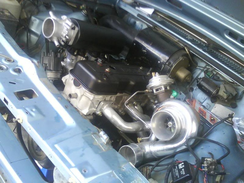

    Grabbed a Rodeo 4ZE1 lower inlet, put a dodgy cylindrical plenum on it with a XF Throttle, injectors were some Bosch ones, cant remember exactly what.

    Now I needed a hotside, which I had, except it was meant to go on my other Gemini. Oops. T3/T4 apparently a 500hp roller core, HPC coated manifold, external gate hanging off the rear manifold [Deltagate, which failed pretty quickly]

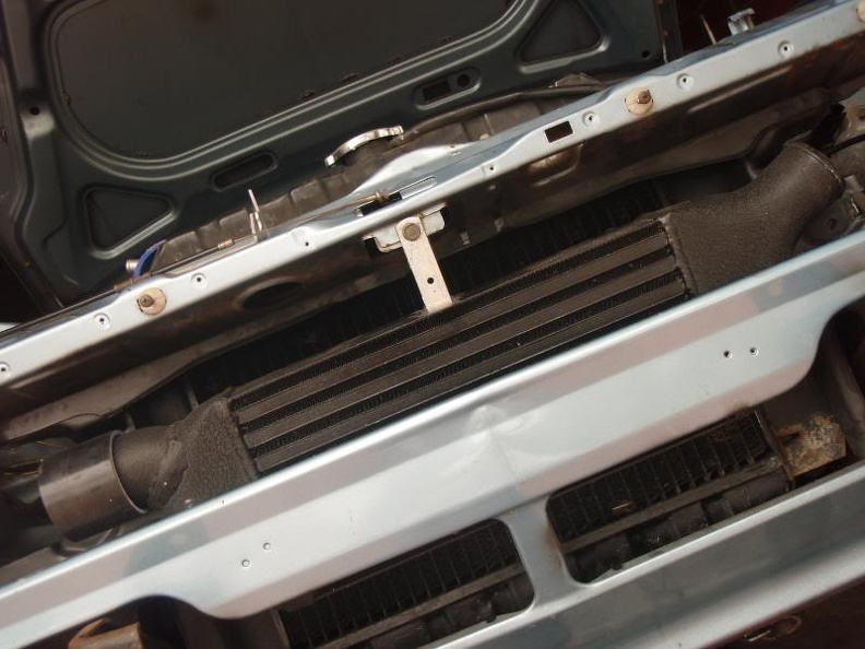

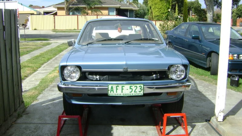

    Hacked up and modified an XR6 Turbo intercooler to fit. Also required some hacking of the car and ditching the square headlights
    Wired up a MicroLeb LT10s through a Magna dizzy/single coil setup to run the thing, had it tuned aaaaaaaannnnnnndd thennnnnnnnnnn…

    Good view of how the cooler went in. Spewin I couldn’t get the grille over it properly though

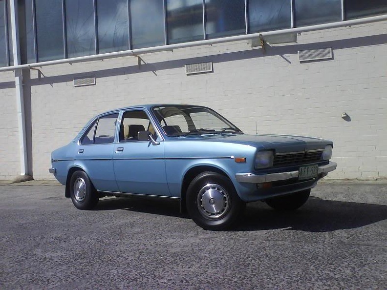

    How it looked before I pulled it off the road and stripped it to a shell to start the rebuild.
