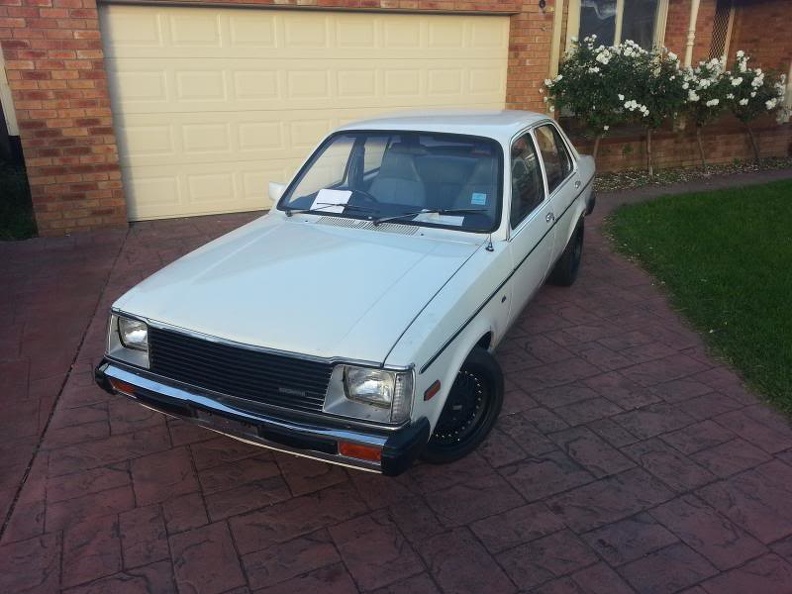

    Have refrained from putting this one up because, well, absolutely SFA has happened over the past 18months or so, but expecting a lot of progress shortly so here goes. Bit of a pic dump to catch up but we will start on some somewhat-related background. Begin Cool Story Bro. A few years ago now I screwed together an L67 powered VS for the nopics to use as a daily. Started with a basket case her dad for some strange reason had sitting in his carport. Photos cannot accurately convey how shit the thing was.
    Went through the whole thing and gave it a quick respray, replaced the whole interior [fucking cats] new suspension etc only for the thing to blow a headgasket a week after being on the road. Replaced dead engine with L67, Berlina trim, new rad, new this, new that, and so on. The result was, for a rush job, surprisingly half decent.
    And then the headaches started. Kept dumping its coolant on shut off – went through three radiators before we discovered it was the cheap aftermarket rads that were causing it – filler neck area wasn’t machined right so once the cap would soften up it would start to leak. Then the auto went. Then two power windows. The seat went into autofullysick mode [it reclines by itself]. Then the exhaust fell off. Then the front brakes caught fire. Replaced them with new ones, then they caught fire again. The roof lining and all the plastic trims around the back window feel down. The ignition barrel broke. Then the panhard mount snapped. Then her brother crashed it.

    Couldn’t find a decent 6cyl E30 in budget to play with sooo…
    Yes the k’s are legit. Two owner car – retiree for most, young kid for 12months. It leaked water and no longer ran and he didn’t know why – leak was welsh plug at back of block which he never would have found, and he forgot to connect the alternator [runs the fuel pump in these] which is why it wouldn’t run. So out it came, resealed inlet, new sump gasket, new front and rear mains, new water pump, new welsh plugs etc. Basically everything except valve stems and headgasket, which would come to bite me in the arse later.

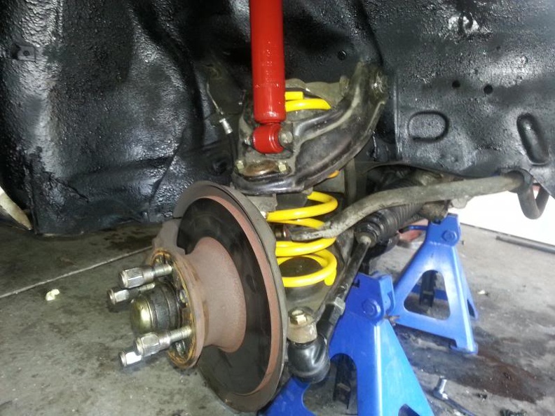

    Rebuilt the front end with nolathane, new ball joints, Gabriel shocks and a “slight” altitude adjustment.
    Set of 15x7 BBS RS Copies

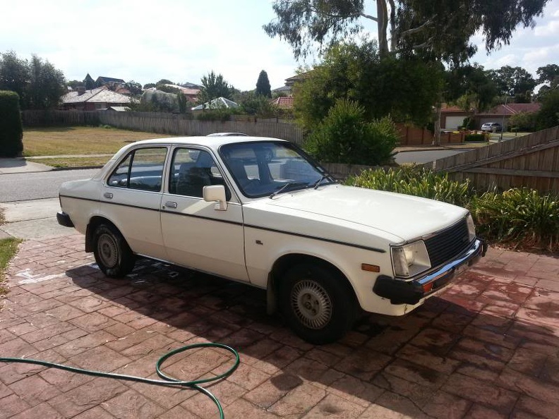

                          Suppose were due for an update. I have really done fuck all on this thing over the past year - its basically sat in the garage on stands 90% complete while life got in the way, with me slowly fiddling with bits and pieces here and there, which means i didnt take pictures of shit so youll have to deal with short snapchatesque videos. Gem Nationals coming up again [Easter] and with the house now being sold I vowed this thing will drive out of the garage. Add to that my car being written off means I needed wheels, fast. Nothing like a bit of drama to get you moving then.
                          Two things have stopped this thing from moving [I dont mean time and money] - one was the carbs were over fuelly as fuck and i have no real idea how to set them, and the second was it randomly developed a no spark issue. It would kick/fire no worries with my points dizzy, but the other two dizzys i tried resulted in nothing. I tried a variable reluctor setup with both a camira ignitor AND a procomp elec box - no dice. Tried a hall-effect points replacement with Camira ignitor - again, nothing. Bit the bullet and bought a brand new, two wire points replacement which has the module built in and all. Two wires - this cant go wrong! No spark. In the end conceded defeat and stole the points dizzy out of the now defunct brown/gold car and whacked that in, which resulted in this goodness.
                          Ordered a synchrometer and got plugging on Friday finishing off a few loose ends like seat belts, throttle linkages, clutch cables. Roddy came down on Saturday and spent a few hours going over the carbs, we bled the brakes out and took it for a whirl. Not going to lie, was nervous as fuck given that the engine was something i built by myself in my garage a few years ago but so far ive racked up around 100km and you can feel it freeing up and wanting to rev. Engine feels good, sounds good and from the short stab of the throttle here and there seems like itll go pretty good.
                          Gave the old girl a quick bath and although im not really happy with the paintjob on it, it scrubs up ok
                          Need to run the polisher over it and give it a wax, should look ok. Theres still a decent amount of things to tidy up and get around to sorting out before we take off for The Entrance next week. Exhaust is banging on body pretty badly, rear swaybar needs connecting, interior needs finishing off. It drives ok on the carbs but we still need to put a wideband up it, has an annoying small backfire/spit out the carbs if you are slowing down from, say 3500 and then pick up the throttle lightly. Its also an absolute cunt to start regardless of if its hot or cold. Also idles high when warm but way too low when cold. Hooked up the vac advance which helped a little bit, wondering if i need to up the base timing a fraction as its currently on 10BTDC although thats already pretty high.
