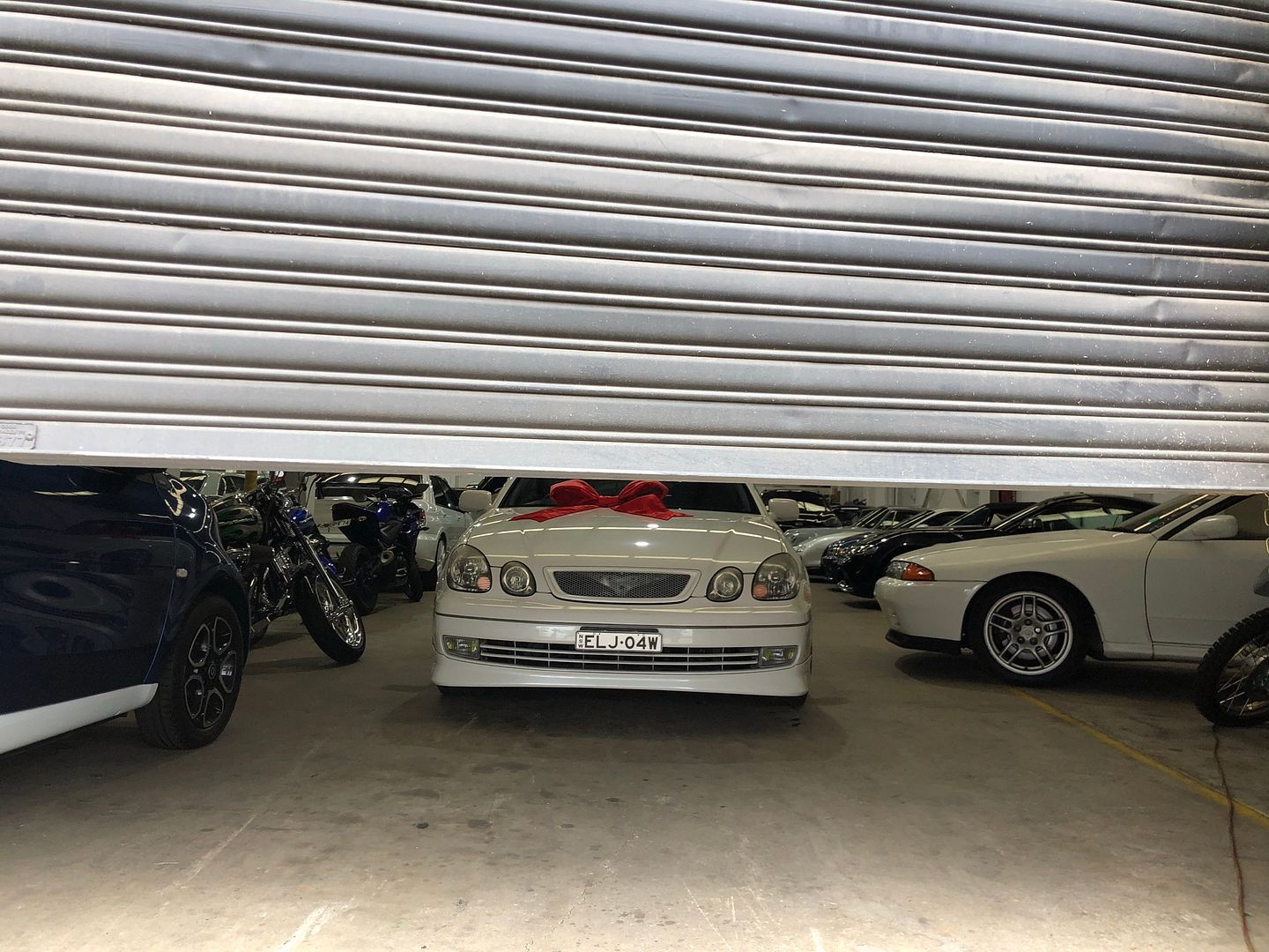

    But I'm getting ahead of myself. A few weeks ago, Graeme at Top Secret Imports called to say that the compliance process was all done and the Aristo was ready to be collected...
    We excitedly went over to pick her up and the car looked to be in great order, so we gladly accepted the keys and set off for home.

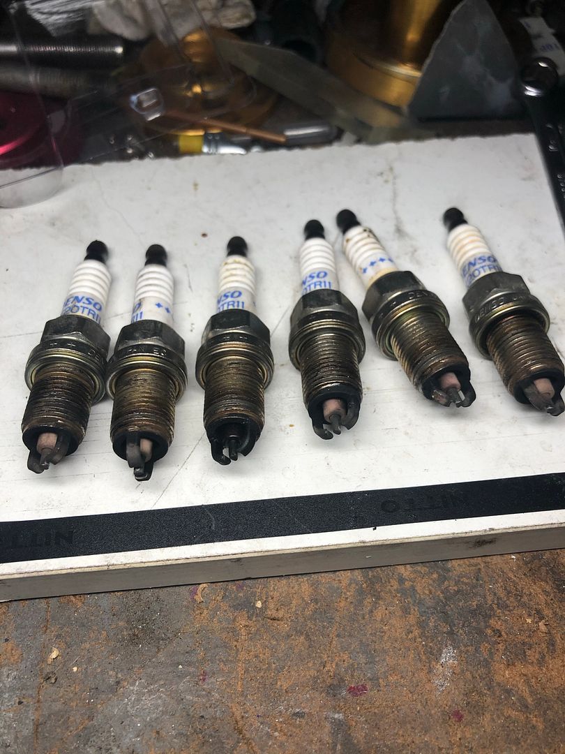

    Hence the poor spark and intermittent miss...which was now addressed but hadn't totally gone away. So let's open her up for a look.

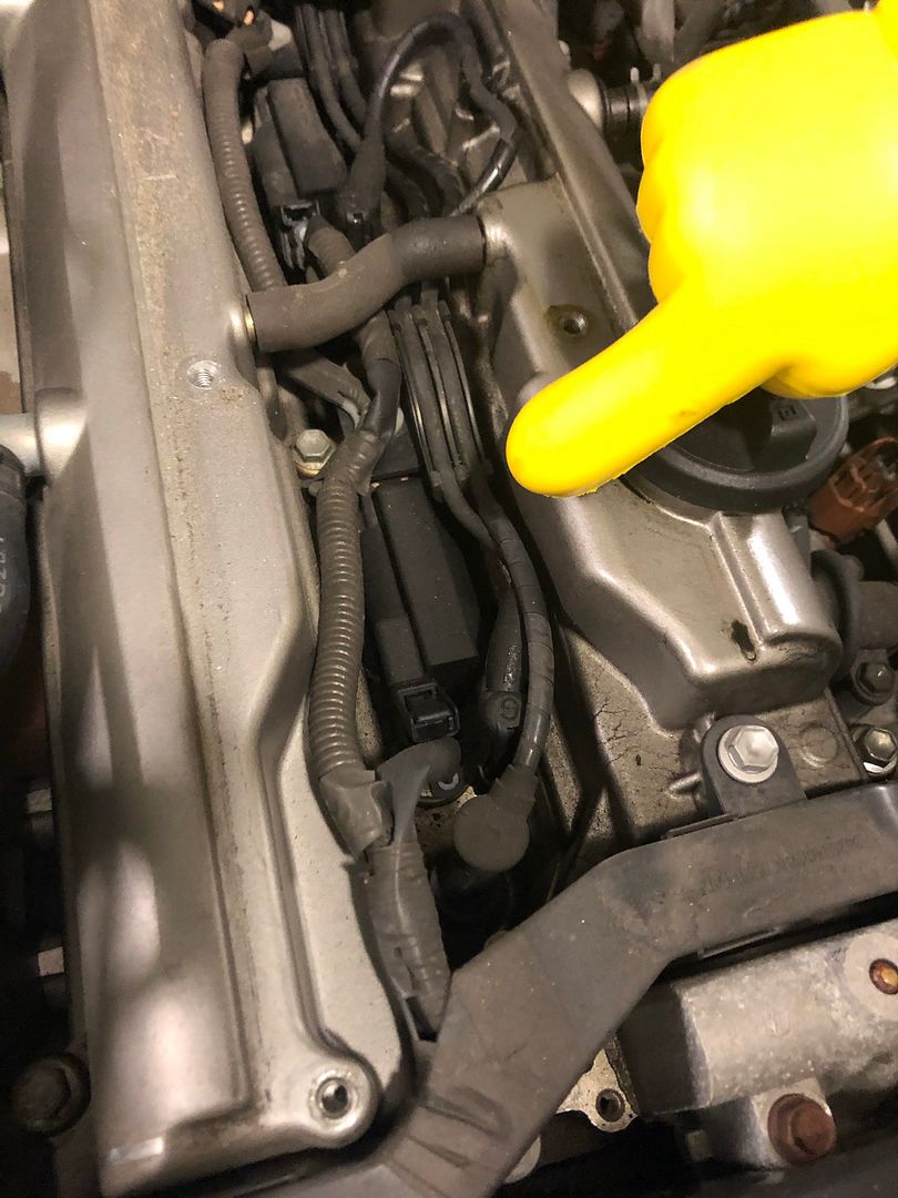

    The Aristo comes with the later VVTi version of the 2JZGTE, which means that it has three coilpacks in a wasted spark arrangement. That means that when each coil engages, two spark plugs fire simultaneously: one in the actual ignition stroke of the combustion cycle, and the other plug will fire harmlessly in the exhaust stroke of another cylinder. So to have a look at the plugs, we need to remove the three coilpacks, as well as the short plug leads that run to the remaining three spark plugs.

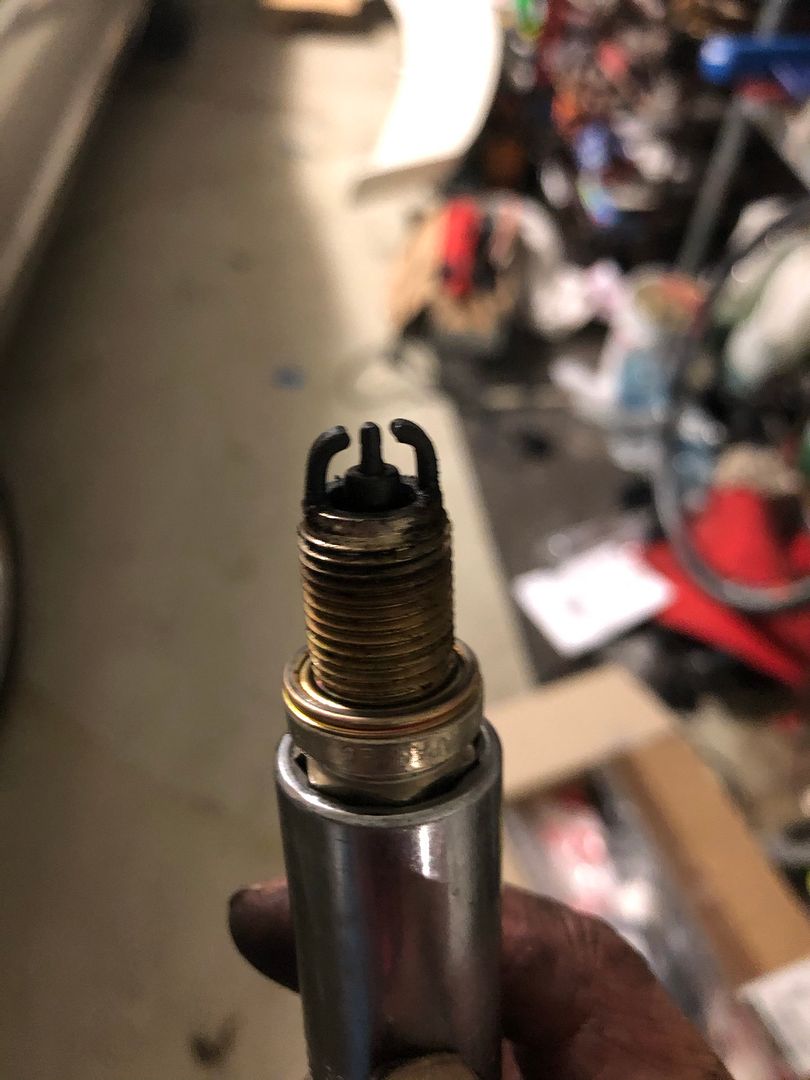

    It didn't take long to discover that the #3 plug was badly fouled. The other 5 were fine, with a dry brown deposit (what the JDM mechanics call "fox colour") but #3 is definitely gone.
    ...that's why she's spittin.

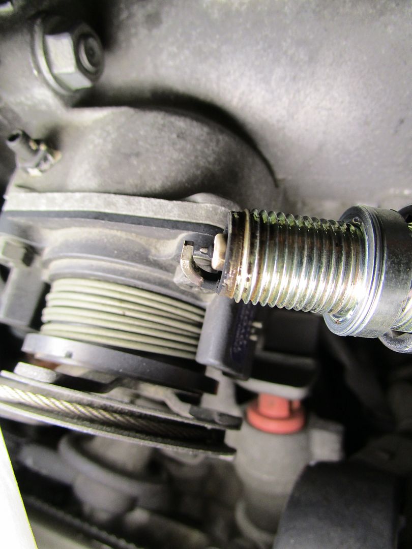

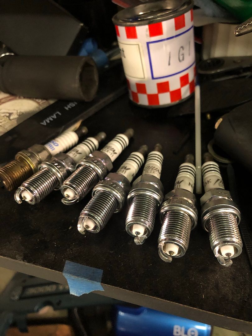

    Out with the old, and in with a new set of Iridiums, which I adjusted down to a smaller gap of 0.8mm to go along with the increased boost that we're planning to run.
    And with that, the 2JZ was now butter-smooth and revved freely. Much faster now too. Just to check that #3 piston is okay, I pulled the #3 plug a few weeks later and it's squeaky clean. Phew. I guess the power supply issue meant poor spark and incomplete combustion, and one spark plug had to fall first I suppose, and it was this one.

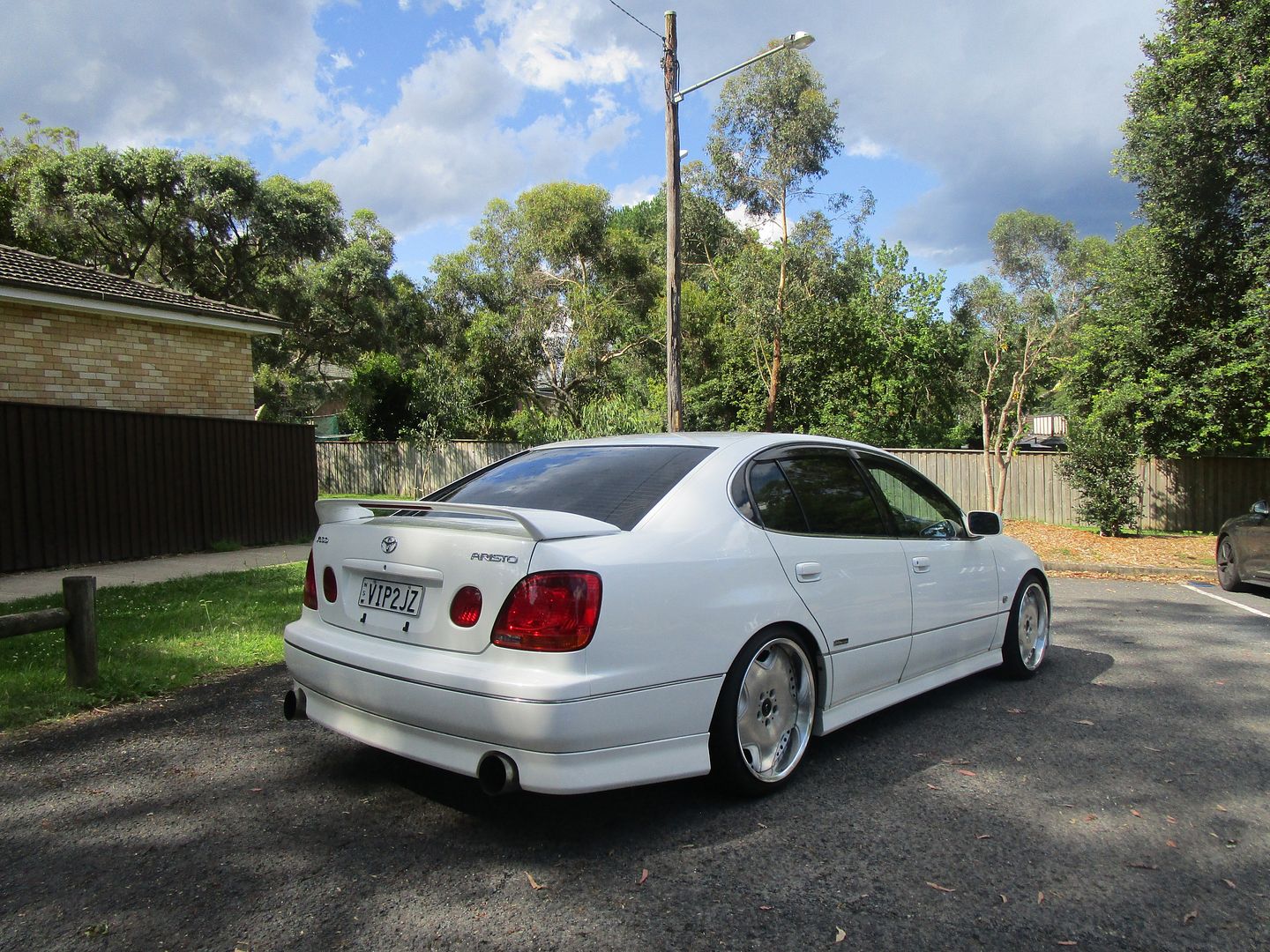

    The Aristo is a V300 Vertex Edition; the V300 part means that it's the turbo version (the NA version is called S300) and the Vertex Edition is just a trim level. Getting the Vertex Edition meant you got bigger 17in wheels, a bootlid spoiler, and a charcoal colorway for the interior with black seats and black wood. The non-Vertex Edition got 16in wheels, and more of a grey/tan cabin.
    In both trim levels, leather was a pretty rare option.
    Mechanically all V300s are the same, and apart from having the twin turbo version of the 2JZ, the V300s also got rear wheel steering, with an electric rack in the rear subframe steering in the same direction as the front wheels to add high speed stability. I think I can...kinda...feel it working, the faster you go on a winding road, the more steering lock you seem to have to apply to turn in.
    My Aristo is stock with the exception of lowered Tanabe springs on oem-replacement shocks, and the surprisingly deep bodykit is the dealer option Toyota one.

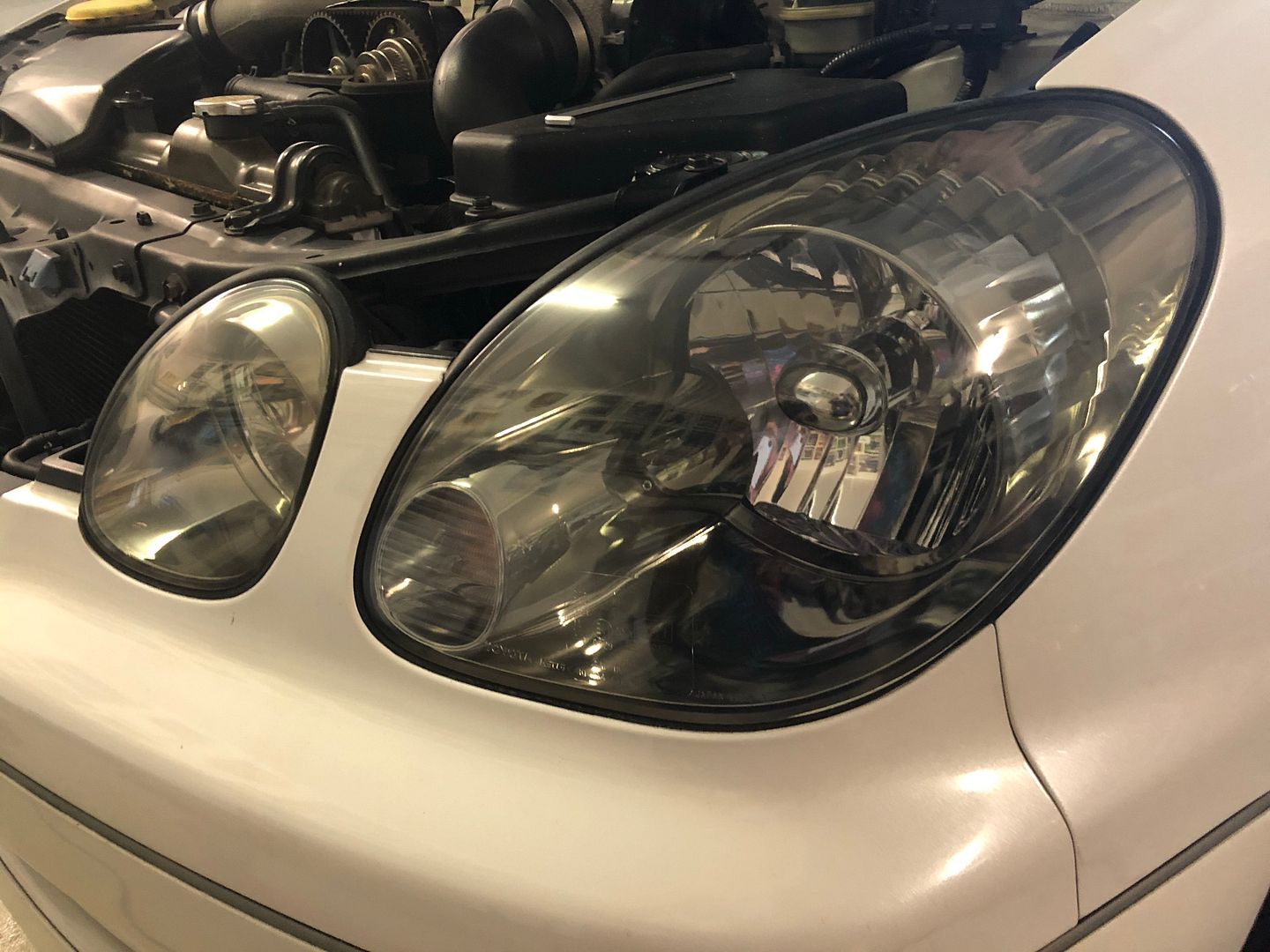

    But I was enjoying wafting along in it, it's got that 90's Toyota overbuilt feel to it, where everything is completely and utterly solid. The doorcards feel like billet plastic, there are zero squeaks and rattles and it feels like it'll last forever. Jack it up and the doors open and close without any body twist. But we can now begin the cleanup, which has to start with the horribly cloudy headlights. My go to product is Duragloss plastic polish, which works a treat.

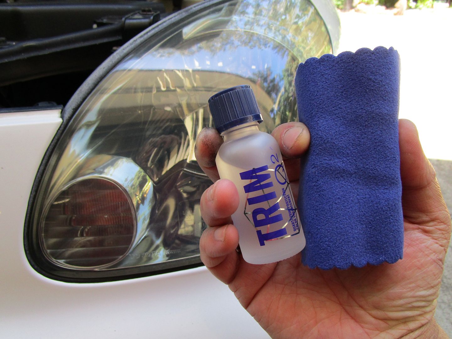

    In conjunction with a cutting pad and a machine polisher, 99% of the haze was gone in just one pass.
    To provide some UV resistance to prevent the headlights yellowing again, I apply a few coats of Gyeon Trim, which will last about a year. You just put a few droplets onto the suede cloth, wipe it on evenly and then buff it off with a microfibre towel. Repeat a few hours later and that's it. This stuff works really well on the exterior plastics to make them glossy and black again too.

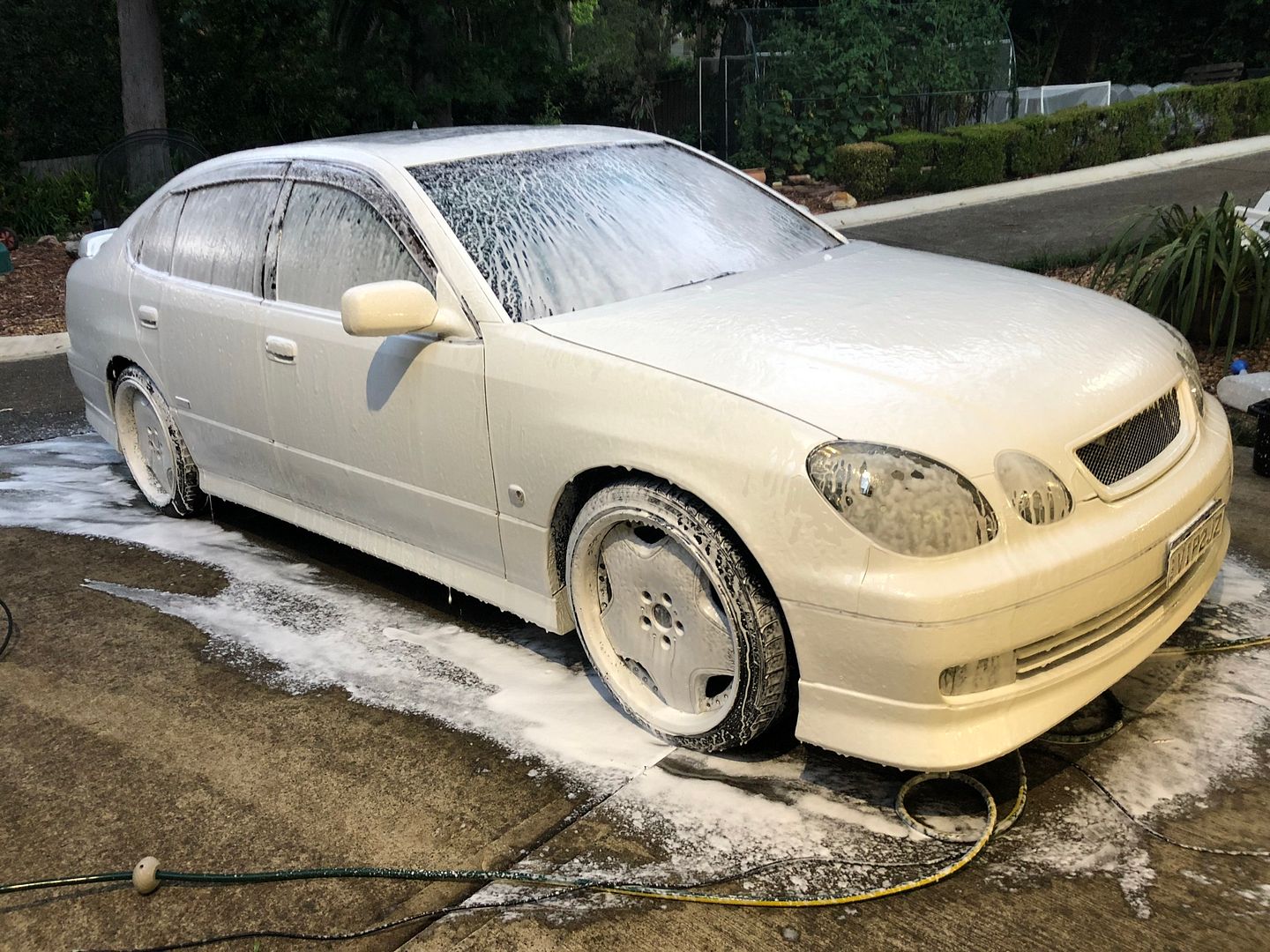

    I've left the big paint correction and coating exercise for another day, but she cleans up just fine.
    Actually it's in astonishing condition, with no dents or scratches, and it's all original paint except for the front bumper, which looks to have been redone at some point.
    The paint isn't even swirly, I just gave it a quick once over with Menzerna Heavy Cut to basically just decontaminate it, and it came up so good I didn't take it any further. Iron Chef always has that knack of sourcing me that perfect car, the previous one was the FD3S, which was also unfeasibly mint.
