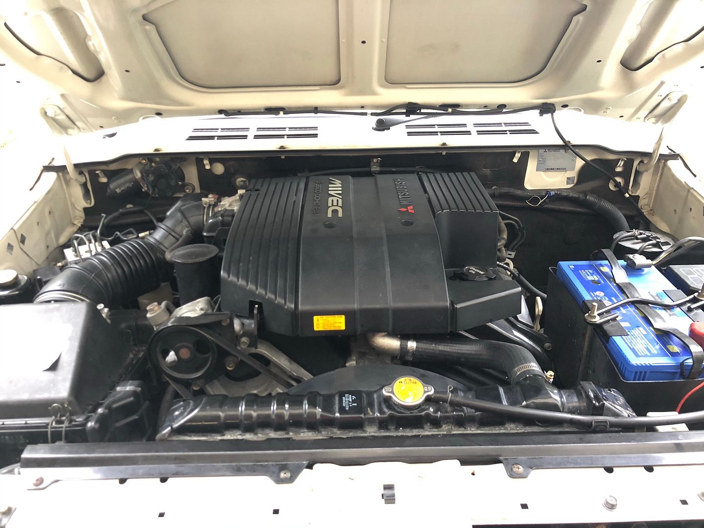

    The 5 speed manual gearbox was taken from the turbodiesel Pajero, and the auto option was also a 5 speed with tipshift. The motor is based on the JDM version of the 6G74 3.5 V6, which was DOHC and 24 valves, but the Evo scored the addition of MIVEC variable valve timing, which in the 90s was like a Honda VTEC system, in that it the motor would switch to a bigger camshaft lobe at high rpms. Suitably equipped, the Evo was rated at 280ps at 6500rpm.
