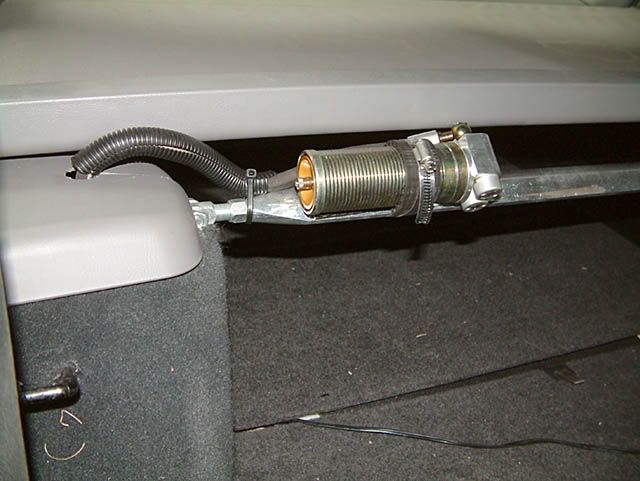

                      Forgive my stupidity, but what is that gizmo on the strut bar? I mean I can take a guess but what it looks like it does, but yer.
                        Remote damper resevoir,
                                nitrogen reservoir and has the high & low speed compression damping adjusters.
                                (rebound adjust is on th ebottom of the strut)
