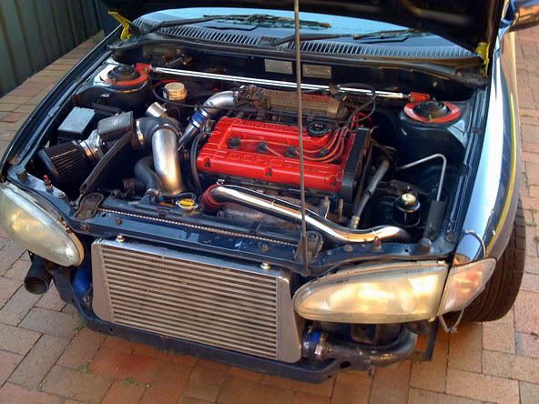

    thats only the top brackets, the bottom was easy i just used about 1/4 thick steel plate to make up 2 brackets that bolt between the caster rod bracket and chassis and the cooler sits perfectly on top of those.

        50x50 probably 2mm alloy on the bottom, and 40x40 <1mm on top

          TK and Andymac: Thats pretty much what I had in mind. Will look the same as TK's but with flatbar instead of the RHS. Already got some holes I used to mount the front radiator fans off.

              It sits ontop of the lower part of radiator support, i cut little holes for the two know bolt things to sit in, on top its just bolted through the top.
                  Yeah, mine is pretty much massive overkill, you could hang a bloody gearbox off of it - I just used what fell to hand, which happened to be RHS & square tube.
                  The bottom mounts are about 5mm thick rhs steel!

                      Just keep pushing the cooler back until there is something above it, drill holes and done :p
                      p.s Just noticed a post by TK thats similar to yours isnt it?? if so couldnt you just hang a bracket off the underside of the bonnet catch to pick up on the plate on the top of your cooler??
