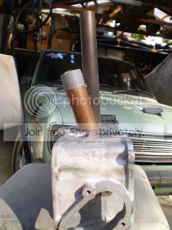

        Out of curiousity, can you see any benefit to raising the inlets a little, filling the floor of the inlet port, and ending up with a slightly "downdraught" style port as shown below ?
        This is what I'm aiming for, as much to be able to raise / angle upwards the inlet manifold, and therefore the exhaust manifold, hopefully leaving just a touch more room for a supercharger and its associated plumbing tucked in underneath both manifolds.
        Might not be as practical for you, I reckon you'd end up with those lengthy trumpets poking out the bonnet

              Dave - if you're doing it to move up & angle the intake then I guess it's worth it, but if you're doing it just to raise the intake for better flow then I think the gains probably won't justify the effort.
                    Thanks for the reply. Yeah, I'm mainly doing it to make it easier to physically fit everything on the passenger side of the block (both manifolds, supercharger, supercharger plumbing, etc). I figured if it made much of a performance difference, you'd have done it.
                      Awesome looking throttles, but I suppose manifold + DCOE + trumpet is about the same length as that?
                        Yep, but the weber manifold has to have a big kink in it as the weber style TB throats are significanly further apart than the ports - so you end up with an S-bend in the intake.
                        With the Munyard setup it's a straight shot, slightly angled for good swirl - a much better setup & only a few bucks more than an EFI hardware setup with a Datsport intake.
