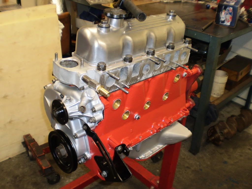

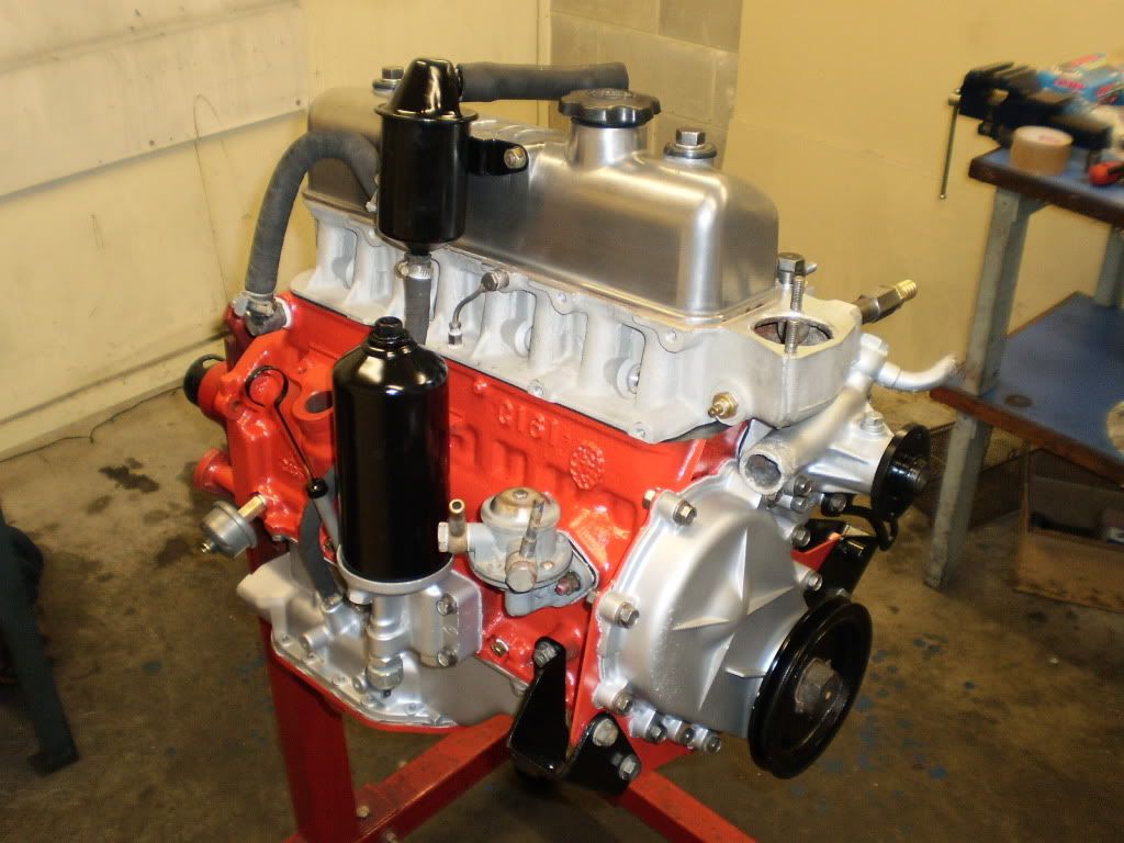

              Motor all done:

                The head bolts look like they've been stolen from a tractor!
                  #98
                  lol its funny how alot of old engine look so agricultural. Looks awesome though...interesting to see a pre crossflow G-series engine!

                    He didnt spring for a new water pump?
                        When I was there on Saturday Tones told me that you could not get them. He has rebuilt that pump with a universal kit.
                          Yeah, pump rebuilt with a new universal bearing (the shafts are oversize & long, you just cut & turn them to the sizes you need) & a new seal.

                              Yup, well worth it - the owner dropped in this morning & the look on his face when he saw the finished motor was priceless.
                              Total cost for the full engine was only a tad over $4k - including cleaning, blasting & painting all the ancillaries etc.
                              Cost was kept down due to not actually needing many parts, mostly labour.
                                Awesome stuff Tk - awesome there are still blokes like you with the skill and desire to keep the old stuff alive and not letting it fade away into total obscurity - and I reckon the bloke got a freaking bargain!
