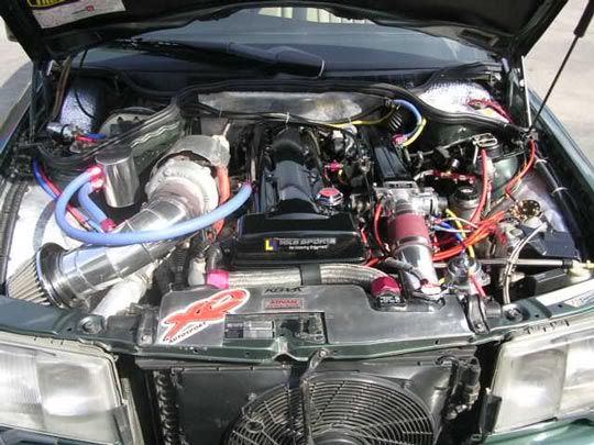

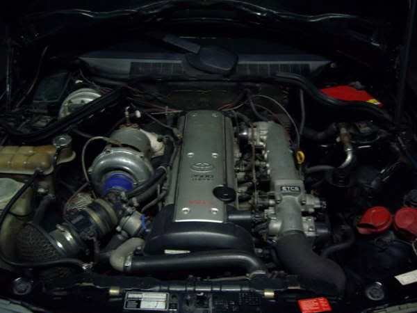

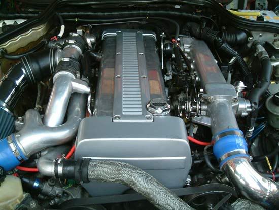

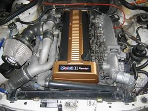

      The following are all 190Es (from Thailand!)
      1JZ Standard turbs
      1JZ Standard turbs
      1JZ Standard turbs
      1JZ VVTI Bigger than standard single turbs
      2JZ Big single turbs
      There is actually a 190E around Brisbane with a 1J conversion already done. I've seen it in the flesh. He actually used the standard 1J engine mounting arms and redrilled the cross member to suit. No additional welding or fabrication was required - not sure on the mounting rubbers. Gear shifter comes up through the standard hole.
      On a right hand drive car, it is actually more conducive to use a turbo engine. Getting a nice set of extractors between the engine and the steering box for an NA engine would result in future blacklisting by exhaust builders and $$$$
      The only issue with a 2JZ to be investigated is whether it would fit with the standard twins or not. Don't want to have to go big single straight away just to get it running.

        I assume (hope?) you mean turbo manifold, not plenum. As it happens a single-turbo setup is more likely to fit than the standard twins, which make the engine unusually wide at the extreme rear.
        All JZ engines share the same bellhousing bolt pattern so yes the same transmission can be used on a 2JZ. The only question is whether the slightly larger/wider turbo setup will foul the steering box/brake booster/whatever, and whether the bonnet will close (2JZ is about an inch taller).
