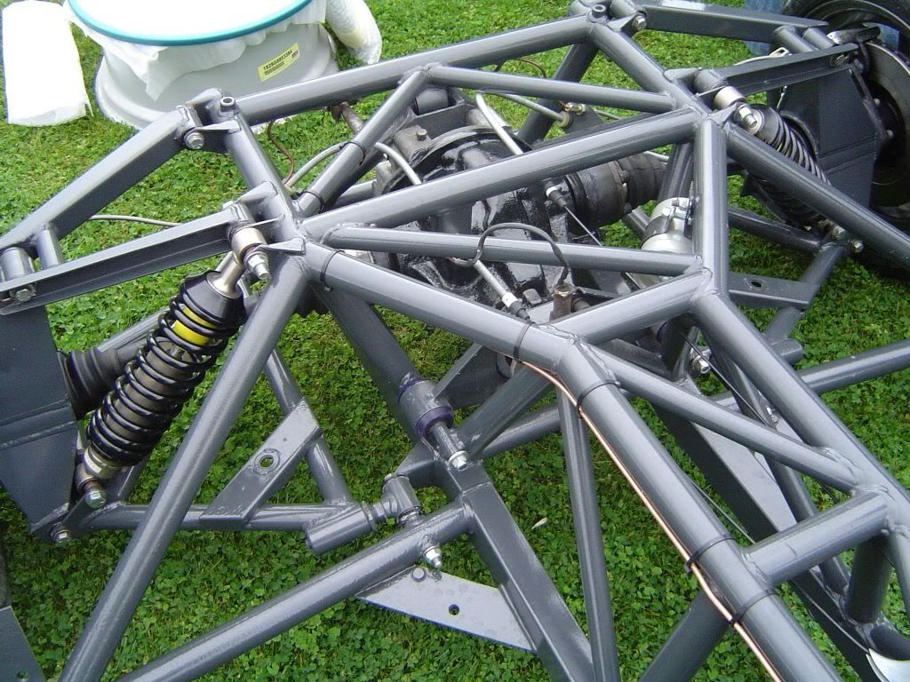

          Yes.. TVR's have a frame.... made of 100% british steel
          Here's a shot of a Griffith frame.. however all TVRS are similiar
