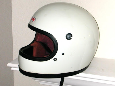

                        Sounds like they are putting an awful lot of weight into that Hurt report. The information used in the Hurt report was actually gathered in 1976/77, it was compiled in 1981 meaning the data is actually 35 odd years old. The sportbike class hadn't even been invented yet and to be fair, the bikes of the day were quite slow and handled like a wheel barrow with a flat tyre. Harry Hurt actually died in 2009 at age 81.
                        Here's a picture of a helmet from that era:
                        Why they would even reference a study that old is beyond me let alone elude to the fact it is a superior study to any that have been done since.
