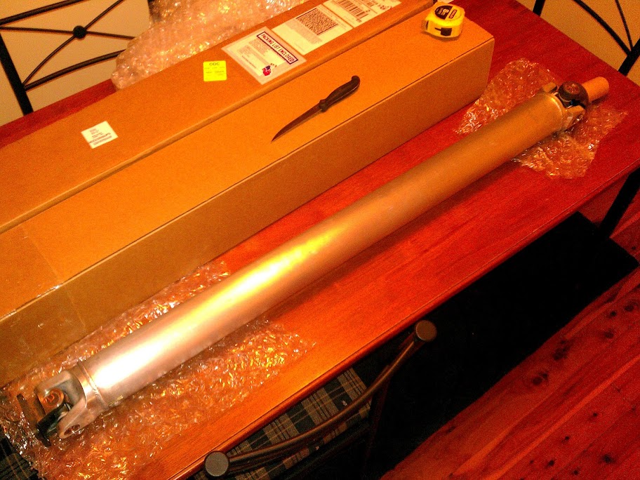

                  psi999 on here got a 3" aluminium tailshaft with brand new unis delivered from Texas in about 5 business days for about $600. I was going to use them too, but Al was able to organise a new 3.5" mild steel shaft locally on the Sunshine Coast.
                  Very happy with the job the above did, unbelievable turnaround and cheap as fuck.
                  3.5" shaft with spicer 1350 & 1310 uni's (Nissan Titan 32 spline slip yoke and Nissan R200 Flange)
                  happy to pass on my contact details for the bloke i dealt with.
