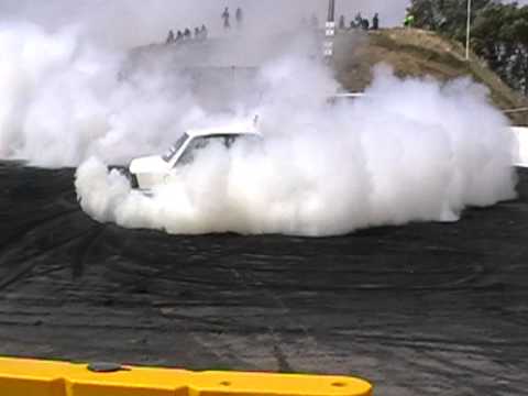

    Mondo giving the 355 hell at the speedway city burnout comp on the weekend - 8600rpm the whole time from a holden donk:
    http://www.youtube.com/watch?v=PjpAplR6vQM&feature=plcp

    thumbs up for one sweet sounding engine!
    nothing like a 8000rpm + revving
      I can't take the credit for mondo's engine - I just do the machining, prep the heads & shit, he built the dry sump setup & does his own assembly.
      Got that thing well sorted now, it's just got a harrop cast crank, scat rods & beat up SRP slugs in it, 4-bolt mains & massive overkill dry sump setup.
        Have seen RVK at gazzanats. Sounds angry and does like a hard time
        Originally posted by RVK 355
        Hold it flat cunt
          Fuck yeah. That's awesome. Sounds so clean
            Dammit where is the like button!
              such a sweet sound, that 355 did not even miss for a second, respect!
