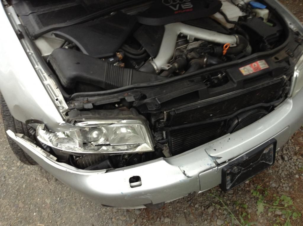

    Reo headlight washer hole doesnt line up with the bumper too well. If that is fucked then that bumper is nowhere near an easy repair. If its just the skin, not bad at all.

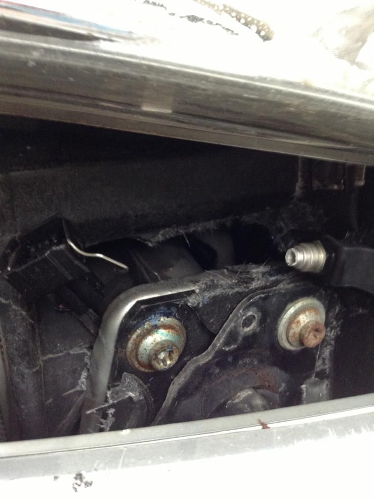

    Would be good if the cunt took a picture of the frame rail right there from above with the bonnet open. That is right where they bend. It is *possible* to repair by cutting it off and welding in a new "horn" or a frame rail straightener.
      Looking at the AC condenser, its taken a bit hit and popped out quite a bit. Will be lots of work in it.

        Wouldnt suprise me if it did , the timing belt looks like it might have taken a hit .
        I'll put a bid on it , I have a spare engine , cams etc here and an RS4 bar , was waiting for something like this to pop up
