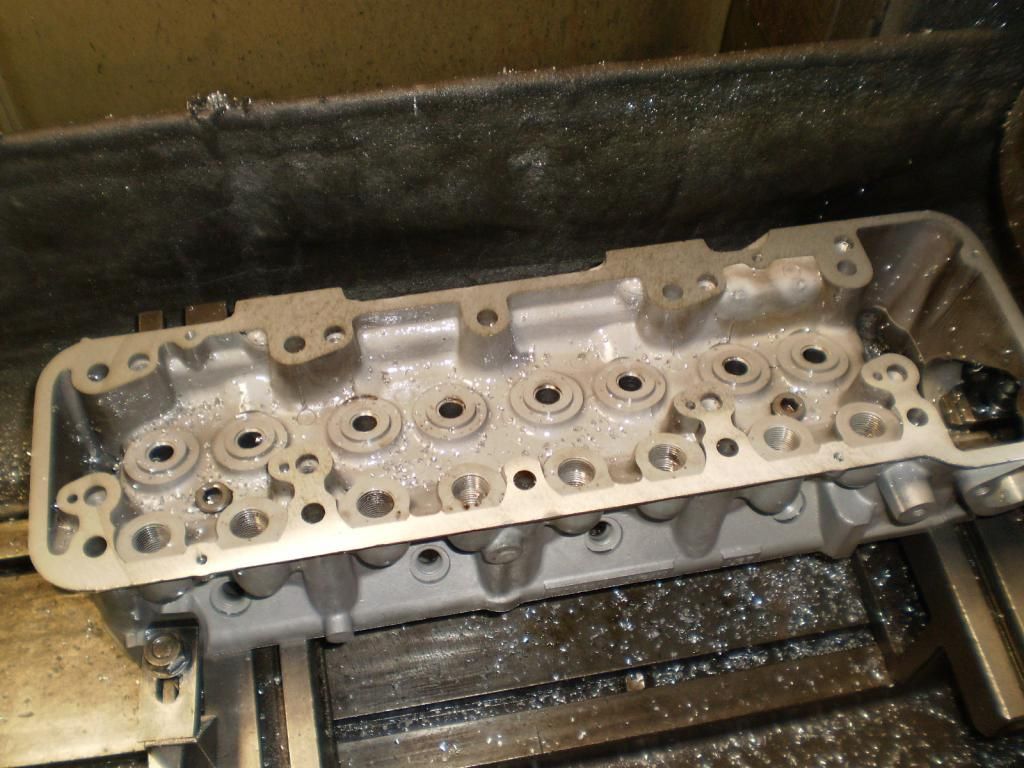

Starting with an open chamber U67 L20B casting - it doesn't really matter which head I started with as long as it is a big port one, you'll see why in a sec.
Aiming to make a really, really powerful 2L datto:

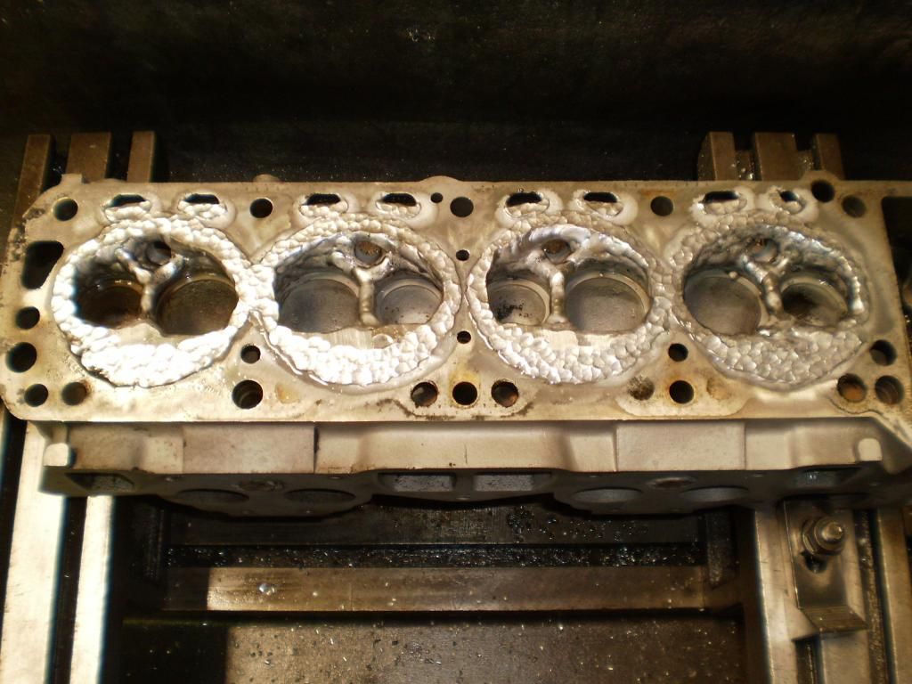

Got it all stripped down, seat inserts & guides out back to a bare alloy casting, then out with the TIG welder & spend a couple of hours making rods disappear:

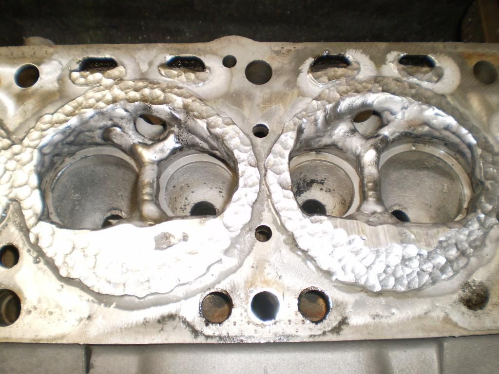

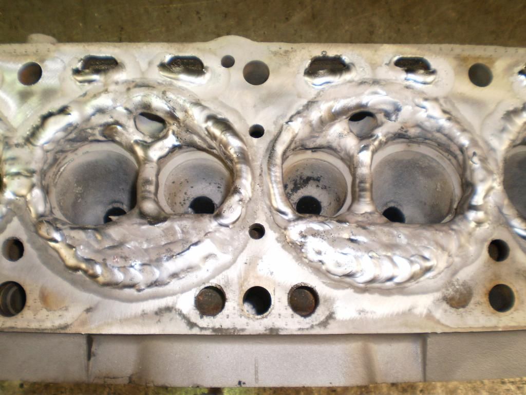

Snip some time while I straighten out the head (bent about 1.5mm from all the welding), then on to the mill, rough the welds down to .040" from the original face & then peen the bejesus out of the welds to compact & work harden the softer welds:

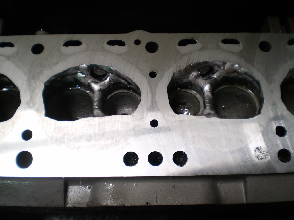

Mill it down to a clean surface:

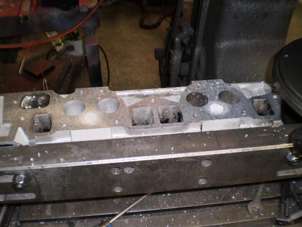

Top face gets a light skim to get it nice & flat:

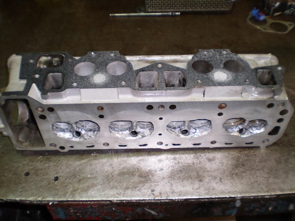

Same goes for manifold face:
That's that bit done:
